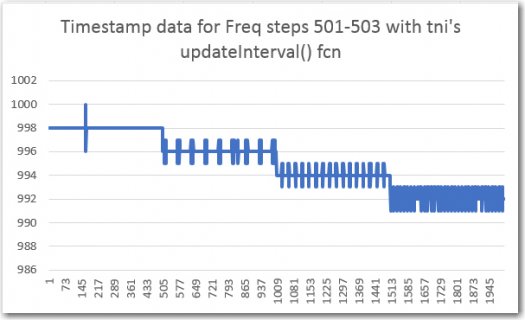

tni, thanks for the prompt and very helpful reply. I added your function to my IntervalTimer test program, and got the following results.
If you compare this screenshot with the previous ones, you will see that tni's update function did the trick - no ugly transition spikes - YAY!!

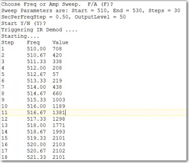

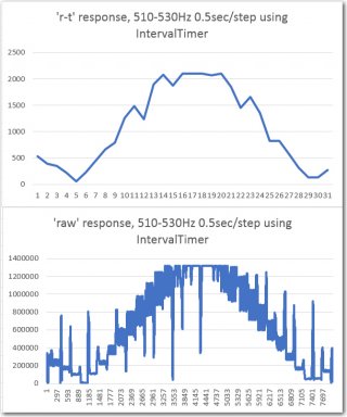

After seeing this, I modified my sweep generator program to use updateInterval(), and ran a sweep on my 'degenerate N-path band-pass filter' set for 520Hz center freq, with the following results
For reference, here is that same test using IntervalTimer, but without the updateInterval() magic
Thanks to Paul for creating the wonderful Teensy 3.x SBCs, to Daniel for creating the IntervalTimer class, and to tni for the updateInterval() fcn - I have been fighting this frequency sweep problem for a while now, and these latest results really made my day!
Daniel, would you consider modifying your IntervalTimer class to add the updateInterval() function as a class method?
Now that I have the thing working (correctly), I'm thinking of creating an Arduino library class so others can use it. Right now it uses standard serial port prompts and user entry parameters to generate frequency or amplitude sweeps (as shown below), but I think this might be too clunky and/or restrictive for a library implementation. Any suggestions along these lines would be appreciated, up to and including "that's a really bad idea!" ;-).
