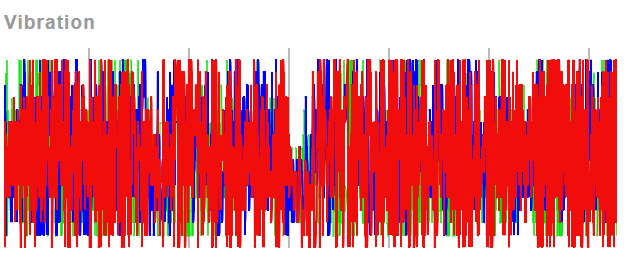

After an amount of time, sometimes 30 seconds, sometimes 10 minutes of working correctly, the LIS3DH starts to give random values, from -32768 to +32768.
I originally thought this was an issue with the shared SPI bus, where, in the accel_ready() ISR using both lis.read and radio.startWrite somehow messed up the communication. However, when I remove the radio.startWrite from the 5 second interval data sender, the program runs fine overnight without any issues with the accel. This made me investigate further, and I have a flag variable called interrupt which is set to 1 or 2 depending on which ISR is called. this is set to 0 just after noInterrupts() is called in the 5 second interval and printed just before interrupts() is called after all processing has been done in the function.
This should, in theory, always produce zeroes right? However, my Serial output is below:

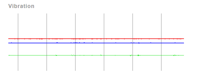

This data, among other things, is sent via a websocket and drawn on a website, just for a visual indication of the output of the LIS3DH accel in working order:
This is the LIS3DH output once it fails:

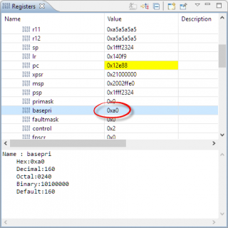

I noticed there's this function -
NVIC_SET_PRIORITY(IRQ_PORTA, 60)
Here's the BASEPRI register, how should I access it?
Is there a function in Teensyduino to set these interrupt priority numbers?
Yes, that's the function which configures the priority level for any interrupt.
If you want to access the BASEPRI bits, you will need to use a small chunk of inline asm with the MSR instruction.
Thanks for the reply,
I've been away for a week so not able to test anything, I'm afraid I don't understand much arm-specific code so this may be a stupid question, but does PORTA refer to 8 interrupt pins? if so, is there a table showing which pins refer to which PORT?
Also, when you refer to MSR in asm, you mean call some assembly code in my C program with:
asm("
MSR //code
right?
