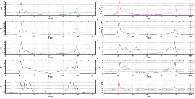

The plot below shows the 2.2 mph frequency channel as I walk directly away from the sensor out to 80 feet, then immediately return the same way.

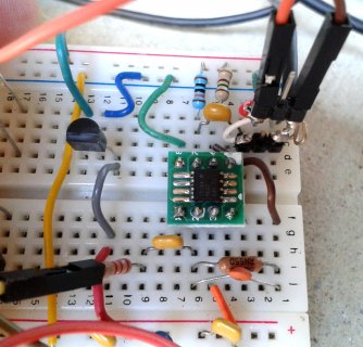

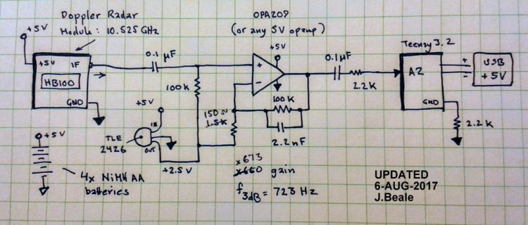

opamp preamp circuit for HB100
Hi Frank, the circuit I used is shown below. You can use any opamp you like. I chose the OPA209A as it works on +5V and is low noise, although comes in SO-8 so I had to use an adaptor for my solderless breadboard. I am running the HB100 + opamp on a separate 4xAA NiMH "5V" supply to reduce noise. The Teensy runs off a noisy USB +5V and you see there is a 2.2k resistor connecting the circuit grounds. I found that if I connect the USB ground direct to the opamp ground I saw much more noise. This is just a quick prototype and I need to think about how to make one +5V power supply clean enough for both circuits.
I used the TI TLE2426 3-terminal "rail splitter" device just to generate the +2.5V common from the +5V supply. You could also do this with resistors etc.
EDIT: Schematic not quite right; I first tried a gain of 67.7, but then changed the 1.5k to 150 ohms for a gain of 673.

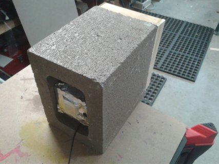

For example, one location I had in mind was on the front porch, to detect people coming up the walkway. In that case you don't want it to trigger on people moving inside. I found the microwave signal does go right through a wood door unless there's some kind of reflector behind it.
I'm going from memory but isn't the gain for a non-inverting op-amp 1 + Rf / Rin = 1 + 100K / 1.5K = 67.66. Can someone check my math??

Your formula is quite right. I actually had two versions of the project, and I confused them. At first I used 1.5k as Rin but decided I could do better with more gain, so boosted the gain 10x with Rin = 150 ohms. So the gain is (about) right, but I mislabeled the resistor. I edited the previous post to show the corrected schematic.

to anyone trying this out: I also added the PDF of the horn antenna I made. If you don't add something like this, you'll get a fair amount of pickup off the back side of the device, not just the front.
addendum: plots of other frequency bands
By the way: given the radar range equation says return signal should go as 1/r^4, you may question why my plot looks more linear with distance. I'm wondering that too. If you look at the other frequency bands they are each different, but mostly tend toward a much steeper-than-linear falloff with distance. The upper-left plot "alm" is a linear combination of the first four frequency bins. Might be fun to make an algorithm to look at all the channels, and try to optimize SNR for detecting pedestrians at various distances, cars etc.

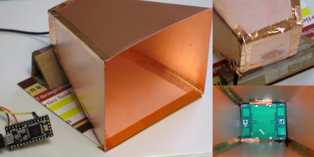

horn made out of PCB laminate sheets
Made a new horn antenna from thin FR4 copper-clad. Was able to tape up the back with copper foil more tightly and the whole assembly is more rigid, so this one doesn't detect a hand waving right behind it, where the aluminum-foil version would. Otherwise performs about the same in the forward direction. Aesthetically looks better I think. The HB100 board is just taped with a few pieces of copper tape flat against the bottom inside the horn.

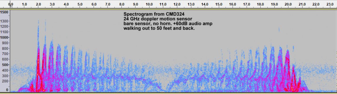

spectrogram from CDM324
Here's what the 24 GHz module CDM324 (without any horn or other reflector) shows as I walk out 50 feet, stop and come back. This spectrogram was generated by Audacity on a Windows PC, sampling at 8 kHz with a 1024 element FFT, so the Teensy would have the same information using the audio lib 1024 element FFT. The trick is to analyze the data to extract "person walking" from "trees blowing in wind" and other noise. Fun how you see the arms & legs moving forward and backwards. By contrast a car is less complicated because almost all parts of it (except the wheel spokes) are moving at the same speed. There seems to be some constant broadband noise around 400 Hz.*
*which turns out to be an instability due to capacitive loading of a reference buffer in my preamp; since fixed.

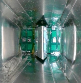

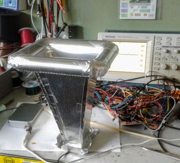

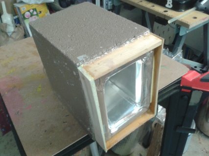

another horn antenna

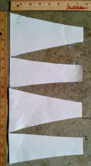

I made another horn using aluminum flashing (thin sheetmetal) and aluminum HVAC tape, with a slight exponential curve (eg. flared instead of straight) and a rounded lip which reduces edge diffraction. Looking into the horn you can see a V-shaped "nose" on the HB100 PCB itself, separating the TX and RX antenna patches. I did not measure it, but this assembly seems to have a fairly smooth pattern, without the distinct separate lobes of the simpler horn design. In theory, this horn should be about +18 dBi (but mine is surely less, as I don't have a clean single-mode feed). In practice, looking at a spectrogram of the output signal, I can distinguish the periodic stride pattern of a single person walking out to about 200 feet, if they are on-axis and moving directly towards or away from the antenna.

I don't have a PDF of the new curved horn. It is not dramatically curved. I just made a mockup pattern by eye out of paper (see photo), and then used that to cut it out of aluminum flashing from Home Depot (if you do this, wear gloves!). I later added tabs at both ends that (rolled over a PVC pipe as former) became the front lip, and folded over at rear for a box to hold the HB100 board. Also tabs folded over along the edge to help hold the adjacent side. It was sized to just fit (except for the curved lip) in a 3 x 5 x 7.5 inch volume, as that is the opening in the 7.5 x 7.5 x 5.75 cement block that I put it in. Finished with wood strips around the lip and .02" polystyrene sheet over the front, and all painted with the same exterior paint as the rest of the house, it doesn't stand out. Both latex paint (after drying) and polystyrene are near-transparent to microwaves.
