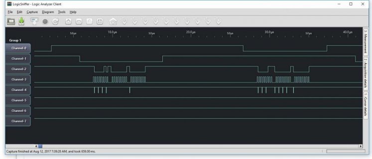

I am attempting to upgrade a previous project, which is using the Arduino Due to convert an analog compass to a digital one. The updated version will instead use the Teensy 3.5 and both versions are using the ADS7871 as their analog to digital converters. To do this some parts of the code had to be changed as they were using the extended Due library. These changes should be as simple as removing the pin select and SPI_CONTINUE arguments from the SPI.transfer command and replacing them with 2 digitalWrite commands first setting the chip select pin LOW before the transfer and HIGH after. However, doing this causes the output to get stuck on 45 degrees, which in binary is simply an output of all 1's.
I have tried using the SPI.begintransaction command to no success as well as a multitude of other changes. Strangely, when I change only a single, specific transfer command (the one dealing with the short "ref") from the due specific code to the general SPI library it still works perfectly. However, if I change the transfer command directly below it (the one dealing with the short "adc") which has the exact same supplemental code it breaks the code just as previously described (outputting all 1's). Attached is the code in its current state which works as designed, with the only deviation from the original code being to the single transfer command dealing with the short "ref". I have also attached 2 extremely simplified version of my code one of which uses the Due specific library and appears to work correctly and the other using the general SPI library which once again outputs all 1's.
Does anyone have any idea what could be wrong with this? I've been tearing my hair out for days trying to figure this out.

Also verified with Logic Analyzer that the data was what I expected it to be, as from your program. I did not verify if your actual commands were correct for the actual device.

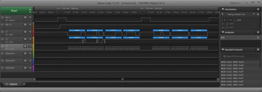

For the fun of it I dug out my one Arduino Due (early version)... Again I don't have your chip so can not tell how it interacts.
I ran your stripped down version of the Due program from posting #1...
I verified the same outputs on the SPI buss and pin 4 as with the Teensy.

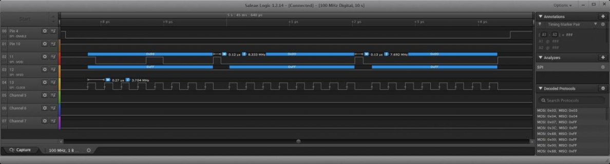

From The Teensy we have:

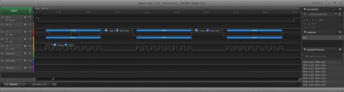

Now with the Due, we see:
Differences: With Teensy the SPI is running at about 3.7MHz where the Due is running at 4.0MHZ.
But the big difference is time between bytes. WIth the Teensy it is only about .12us whereas on DUE it is something like 1.07us or almost 10 times longer delay between bytes.
So wondering what would happen if in the above program for Teensy if you added in a small delay?

I went ahead and gave your new code a try. I wasn't entirely sure what you wanted me to put for "< set pin 13 back into SPI mode >" but my assumption was that simply using pinMode(13, OUTPUT); would be what is needed. Unfortunately, like everything else we've tried so far this did also not fix the problem. I did not get a chance today to try out the change you recommended for the setup but I will be sure to get to that tomorrow.
I did however get around to taking some pictures of the project. They show the old board which is using the Due processor along with 2 Analog to Digital Converters. Also shown is the Teensy 3.5 with the 2 daughter boards with 1 Analog to Digital Converter each. Both can connect to a DB37 and then trough a mass of wires into the compass system for the aircraft. This system include a gyroscope, nob for adjusting heading and a display along with a variety of other instrument which I don't fully understand. Sorry that it took so long to upload these I was having issues uploading them using the Forum's attachment manager so I uploaded them here: http://imgur.com/a/EokQu
So as the summer comes to an end and I head back to school at the end of the week it's time to look forward to what happens to this project when I am gone. I don't want to just cut off you or anyone else that has taken an interest in this project. If you would like to continue to try and solve this strange problem, my boss and I discussed sending you or even a few other interested people one of the "Due" boards from the previous project. That would allow you to at least semi test the code as regardless of getting input from the compass system the output should not be either all 1's or all 0's. If you are at all interested please let me know. Thank you very much Kurt for all of your help, you have come up with idea after idea and gone far above what I expected when I made this post.
