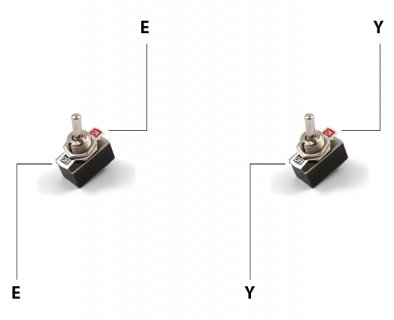

Sorry for my bad english, i'll try to explain it more simple.
I have 2 Toggle Switches, I want to do like this:
One of them I want to press Y, whether i press the toggle switch ON/OFF, the other one should do exactly the same, just press E instead of Y
Hope that I made my self more clear :D
Sorry at least to me, this is still a little unclear.... That is I can not tell from your diagrams and pictures, what this switch is? Is it a Single Pull double throw? That is does it have three contacts on the bottom? Where there is one common pin that gets connected to one of the two other pins when you press it to the on position and likewise connects to the other pin when you press toward the off?
If so, then You need to connect the common pin to one of the IO pins on your Teensy and the other two pins to ground.
Then @RevaLogics - code above should get you somewhere near... If assuming that your Teensy should act like a USB keyboard. As his code also tries to show you things like what should happen if both buttons are done at same time? Should there be any repeating? That is if you hold one of the switches on for lets say 5 seconds, should it only send one key press? Or should it do some form of logical repeat keys.... If so how fast?
To do this, you will also need to setup the Arduino IDE where you set the USB Type in the Tools menu to one of the types that includes Keyboard.
If however you meant for this to act like a Joystick button? then some of the code will be different... But the handling of the switches would be the same.

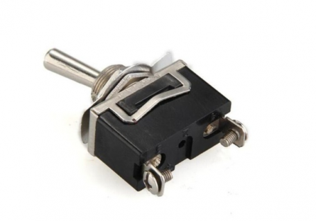

Thank you for your reply, the contacts are SPST (Single pole, single throw), it's correct the toggle switches should act like a USB keyboard, it shall only send one key press, exactly like when you use a normal keyboard and press Y, i just want the toggle switch to press Y, one time, everytime i either turn the toggle switch ON/OFF.
Heres a photo of the toggle switchs bottom
Hope it makes more sense :)
In that case, you can do as mentioned and hook up switches with one wire going to ground and another going to IO pin.
You can then use the bounce library as shown in previous code.
Again I have not used the Keyboard stuff myself so others may need to fill in...
