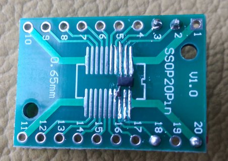

This morning, I tried my new flexbus hardware and I discovered several things:
  • soldering a 74LVC1G04 (NOT gate) in SOT353-1/TSSOP5 package on a SSOP20 breakout pcb is really hard because pins (0.425mm long) are barely long enough to reach the pads but it works :) IMG_20170930_130247.jpg Yes, I know, it is not very nice :p (0.65mm is the space between the middle of 2 pins, it is really small, at least for me)
  • the bad news: a simple latch, even a fast one (3ns) is not the correct component. The result is far better than with the 17ns latch but the latch seems to take too much time to take into account LE signal when it goes up. A positive trigger latch should be the solution. I should receive one in few days now.
  • the very good news: even with arduino console opened, the image is not disturbed by Serial.print. This should have been expected as flexbus usage requires no peripheral access and flexbus settings are made only one time at the beginning. Moreover, my code uses 4 bytes read/write instead of 1 byte access which increase a lot SRAM brandwidth. This also means USB-host should be ok.
