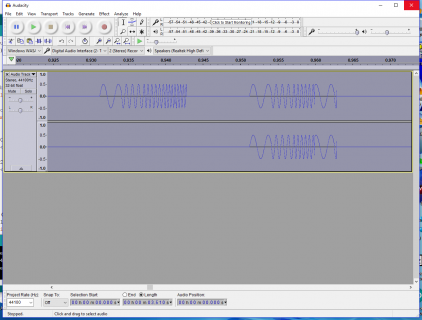

while playing around for another thread I came across a nasty problem
I execute the following sketch

The purpose is to come up with a matched filter, but I'm not there yet.
I use the USB-Audio to transfer waveforms to PC to watch them with Audacity.
I realize severe cross-talking in the two Audacity traces.
I do not know if this is in the USB-Audio part or somewhere else in the processing
Unfortunately I have no osci available that I could plug into headphone to see if cross-talk also happens there
If someone could be please so king to test this for me, that would be very much appreciated.
Edit: @Paul, if you read this, to me it seems a problem with USB audio, as the multiply-rms chain works properly.

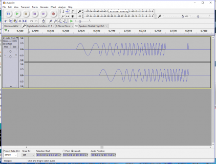

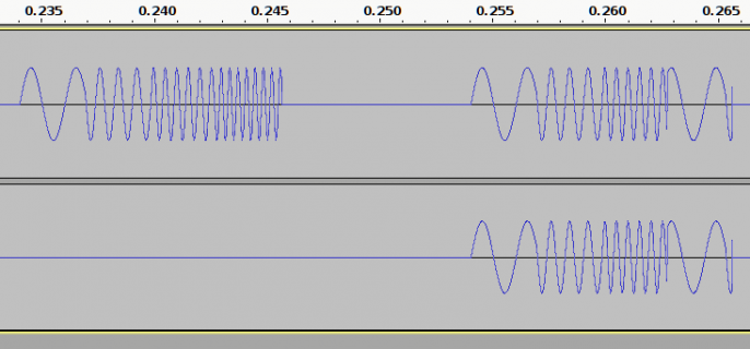

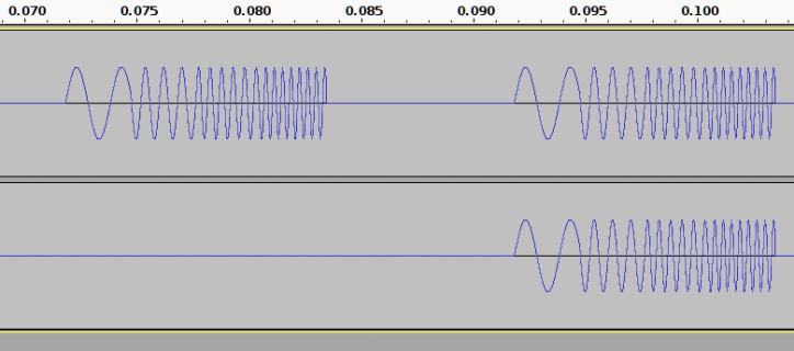

note: delayed sweep (bottom line) is also corrupted
This does not happen for small delays
in fact is starts with delay2 set to 3 ms (!) as shown next

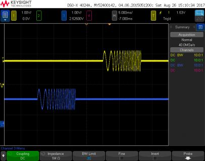

I note that, without accessing usb-audio from PC, this program fine. All reported rms values are the same (0.0)
as soon I access usb-audio (e.g. by opening recoding devices on PC) rms values vary randomly indicating scrambling of audio objects
edit: As delay of 20 ms is longer than the tonesweep, rms of the product of left and right channel MUST be zero
Edit: changed loop to wait sufficient time before carrying out rms so issue is more visible in serial monitor.

OK, after 4 days of continuously hitting the wall, I made some breakthrough
So, I was running

This allowed me to run the above sketch continuously and to read some cross-multiply values.
Following problem persisted for the last week.
As soon as I tried to access the data via usb-audio (e.g. running audacity, or opening record device on PC) data got scrambled and non-zero. they should be 0.0 as there is no temporal overlap.
Shortcut of 4 days of trial and failures, rewriting code etc., I realized something particular weird after I added the AudioMemoryUsage() printout.
If I replace tonesweep with sine, I have no problem with delays and AudioMemoryUsage() gives a value that is nearly constant (as I expected to be).
As soon as I use the new tonesweep function AudioMemoryUsage DECREASES continuously (eventually) flipping over 255 because of the uint8_t declaration.
Let us ignore the fact that at the moment that 'memory_used' is declared as uint8_t (@Paul should it not be increased?).
However, a decreasing or even negative 'memory_used' variable makes no sense, as new audio objects are continuously allocated.
So, I compared sine with tonesweep to see if there are differences.
There are algorithmic differences, we can ignore, so I played around with programming techniques.
Here it comes:
after replacing
    for(i = 0;i < AUDIO_BLOCK_SAMPLES;i++) {
      *bp++ = (short)(( (short)(arm_sin_q31((uint32_t)((tone_phase >> 15)&0x7fffffff))>>16) *tone_amp) >> 16);
by
      bp[i] = (short)(( (short)(arm_sin_q31((uint32_t)((tone_phase >> 15)&0x7fffffff))>>16) *tone_amp) >> 16);
and program started to work properly
(no continuously decreasing 'memory_used' variable, and no corruption of delayed signal)
As the two version are thought to be equivalent, the problem could(must?) be in the compiler. A nasty side effect, however, is also possible.

I'm running it now. There's definitely a bug in the USB output....
This is the correct output I'm seeing on the headphone output (with volume turned up to 0.8):
I'm seeing the same wrong USB output:
My understanding is that after sending the sweep, tonesweep does not send more data, so USB switches to Mono (copying from active to missing channel) That, why I added code to tonesweep
Yeah, looking at that now. It's definitely wrong. There also seems to be a bug with writing to the packets. Might be deep in the optimized copy. As a quick workaround, I'm trying writable buffers.
Please give this a try. It goes in hardware/teensy/avr/cores/teensy3 (not the audio lib).
