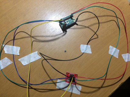

can you attach a photo of your hookup -- maybe you have MOSI/MISO reversed...
Teensy pin 12 should go to SDO, and 11 to SDA on breakout

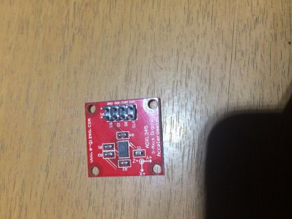

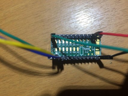

I've utilized an ADXL345 breakout board from the local store, below is how I've hooked the ADXL345 to the Teensy3.2.
Hookup:
Below are separate images of ADXL345 and Teensy 3.2.
ADXL345:
Teensy 3.2:
If the images aren't clear, this is how I've hooked the ADXL345 up
Teensy 3.2 --- ADXL345
3.3V ------------VDD
GND ------------GND
10 ---------------CS
11 ---------------DO/SDO
12----------------DI/SDA
13 ---------------CLK/SCK

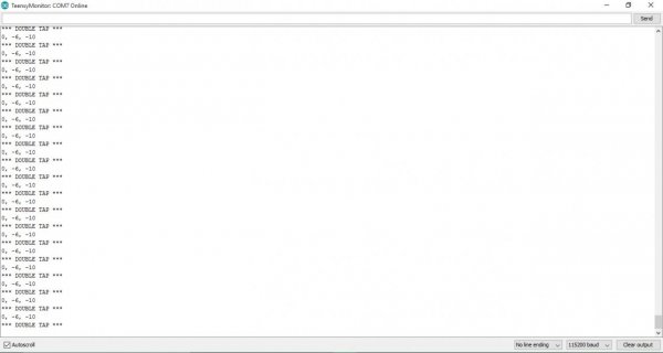

The ADXL345's DI and DO pins are quite subjective, but I think it means that it's DI should go to the microcontroller's MOSI, and it's DO should go to the Microcontroller's MISO. Nevertheless, I've also tried interchanging the two lines and reuploading the code and restarting the microcontroller, but still to no avail.
I've previously hooked up an OLED Screen to the Teensy 3.2 using the ADAFRUIT SSD1306 Library (utilizing SPI pins 10 - 13) and it worked perfectly. I have retried utilizing an Arduino Uno to ensure if the ADXL345 is still working. I've implemented it via the same layout as shown to the table above, only difference is that the Arduino Uno implementation has a Voltage Level Shifter in between the SPI lines. I've utilized the code below for testing (Only difference with before is that the current code now prints values obtained from the accelerometer), and it worked perfectly. I've also utilized the same code with the Teensy 3.2.

Seems like the attachments from my previous post got busted (for me at least), please refer to this post for the images instead:
Hmmmm, I don't see anything funky with the wiring, though jumpers are long, but probably OK for 5mhz SPI. Maybe it's a speed problem, have you tried running T3.2 @48mhz or slower? Or in the library adding a delay after CS low and before CS high.
stumped ??
Yes, I'm actually testing it in 24MHz so that I could actually read the received values through Arduino IDE's Serial Monitor, while keeping the microcontroller's CPU speed low. I've also tested it in 16MHz and 8MHz before, with it's output being shown via an OLED screen connected through SPI pins 7-9 (Adafruit OLED SSD1306 Library).
As for the problem, it seems that I'm encountering constant large values in my x, y, and z acceleration values (i.e., +- 65535). Moreover, the ADXL345 interrupts keep on firing even after being cleared out, though this problem is not consistently occurring (approx 50% of every program start). The values that I'm obtaining doesn't seem to change even if acceleration is applied to the module.
I've just read a thread with similar problems with mine: https://forum.pjrc.com/threads/39769-Teensy-3-2-amp-GY85 and I've tried the revised Sparkfun library proposed in that forum. It did reduced the value that I'm obtaining to a single digit instead of 65535 (reduced to -6, -6, and -10 for x, y, and z values respectively), but the previous problems are still occurring.
And yea, I think the jumpers wouldn't subject the signals to noise that much since my hookup with the Uno is much more worse.
Just reconnected another SPI device to pins 10-13 to check if the problem occurs because of busted pins or funky solders, sadly, the said device worked without problems.

Tried changing int and double variable declarations (as well as casts) to int16_t and float in both the .ino file and the adxl345 libraries. Still not working, obtaining the following values:
NOTE:
Those outputs were obtained while applying acceleration onto the breakout board. "Double Tapping" was not being triggered as well. Even when the breakout board's at rest, it still outputs the same values.

http://www.e-gizmo.com/oc/index.php?route=product/product&product_id=509
That URL shows board has 10K pullups on all SPI lines, and their little demo sketch uses software-SPI (bit bang)! You could try their bit-bang sketch (should work on UNO) but not sure if the Teensy will work with that bit-bang sketch. SPI clock in bit-bang sketch ran at 600khz on T3.2@120mhz.
2) given the 10K pullups, you might try configuring the hardware SPI to a slower speed (UNO default is 4mhz SPI clock). Teensy default SPI clock is F_BUS/8. Max SPI clock for ADXL345 is 5mhz.
3) the faster Teensy might still be causing a problem with speed of setting CS LOW and HIGH, so you could try adding delayMicroseconds(5) after CS LOW and before setting CS HIGH in library (several places)
you might consider getting an Adafruit or Sparkfun version of the ADXL345 or other MPU's like MPU9250
stumped ??
T3.5 i ran 8MHz SPI with 22 gauge solid wire 3x longer than that, to a bank of 8xMCP23S17 expanders :)
Yea, Ive read E-Gizmo's "User Manual" as they call it a few hours ago, neglecting the document in the first place was my mistake, as well as assuming that I won t be needing it even though I'll be interfacing the breakout board to a new microcontroller, with a very different processor than the Uno. I'll give their bit-bang sketch a try in a while.
