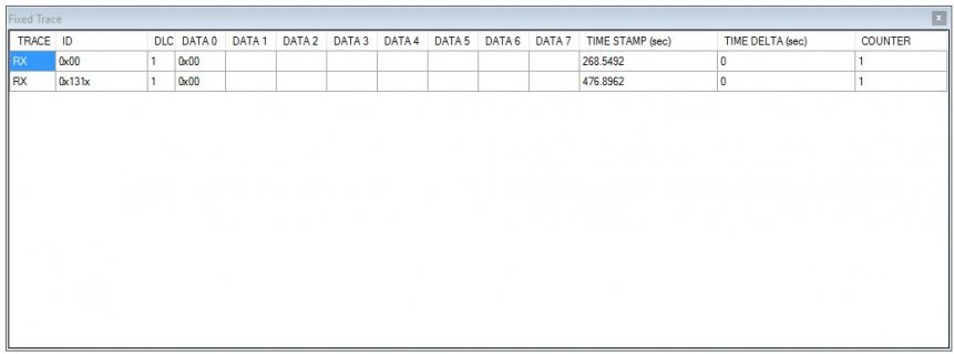

It seems to work here without issue. This is a screen cap of the extended broadcast using your provided code.
The only change I made was to the DEFAULTID. I set it to 0x131 rather than 0, but it works the same with a 0 value for the DEFAULTID
Why does he need filters? I have no filters and my extended IDs work without issue.
Doesn't work for me. Messages with extended IDs are not received without setting up the filters (Teensy 3.6).
Can you post a working example that uses 2 Teensies (or the 2 CAN interfaces on 3.6)?
So, as an update, I suspect tni is right. I was unable to get the object-less version to work with extended IDs. No real obvious reason according to the library readme and I don't have time with having just started school to figure out why.
But at full speed with Can0 and Can1 and a slightly modified version of one of the examples I was able to get an ID of 10000 to work. Code follows:
