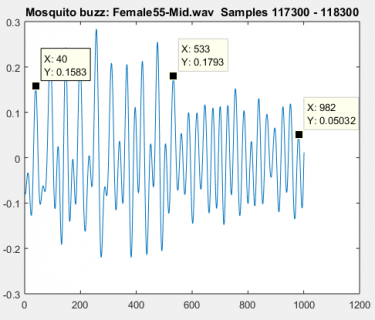

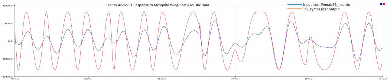

Why don't you simply play your .wav file through the PLL, watch the output on the Serial Monitor and report back here what happens.
This are some of the results. I can't understand the pattern. But seems like its trying to give some valuable information

I just took a look at your data. I think it might not be quite as you imagine it! It might be quite interesting from an entomological point of view :D but this particular data set is DEFINITELY NOT suited to FFT type spectral analysis! Remember that FFT's rely on the fact that there are NO changes in the spectral content, or time-domain statistics, within the data record. Otherwise the results are simply garbage! And that is what I assert is probably happening with your analysis, at least in this particular record. (I think it is an interesting question as to what is happening acoustically - are you REALLY seeing the wing beat frequency, or just acoustic non-linear effects of micro-turbulence and flexural dynamics of the wing membrane generating acoustic energy at random frequencies. I, of course, have no idea;) )
I read Female55_Mid.wav into MATLAB, and plotted out segments in 1000 sample blocks. What I see is that there are many, many very short data segments with obviously different spectral characteristics, and sudden switches between them. For example, here is a plot of samples 117300 - 118300:
Note that 1000 samples represents just 1/44.1 secs (or 22.7 msec) of data. There is an apparent sudden switch in the center of the plot, where the lower frequency on the left computes to a period of (533-40)/9 samples, or a frequency of 805 Hz, while on the right hand side it looks almost like its second-harmonic, with a period of (982-533)/16 samples, or a frequency of 1571 Hz. My quick look through your data shows this sort of thing happening over and over. This will completely mess up any FFT analysis... No wonder your Audacity spectrum was so wide.
These frequencies I see here are also much higher than you have suggested in earlier posts.
I also think that this is what I see happening in the PLL output data you posted - sudden jumps in frequency in the same broad frequency band of 500-1500 Hz.
BUT what is clear is that if this particular .wav file is typical, then the mosquito data is NOT suitable for FFT type spectral analysis to determine wing beat frequency because it is not statistically "stationary". You will always get numbers out, but you must ask yourself if those numbers mean anything.

I was very curious to see how my AudioPLL block actually did on tracking the mosquito wing data, so I modified it to stream the input data and the synthesizer output to the Serial Plotter, and recorded the output from Female55_mid.zip. As I found from my quick scan in MATLAB above, that input file is a complete mess with large frequency jumps all over the place. A sample PLL output is shown here:
The blue line is from the raw input file, the red is the PLL synthesizer output. Again we see a large frequency jump, this time downwards, halfway through this 500 sample segment. As far as I am concerned, the PLL has done a remarkable job of tracking the phase in this data file. Remember, we don't expect the traces to overlay one another, 1) because the synthesizer is a fixed amplitude device (in steady-state), and 2) we expect the dynamics of the PLL loop-filter (feedback controller) to cause transient phase errors during phase transients in the input. I was delighted to see how well it did on a wonky waveform.
A quick estimate on the frequency on the lefthand side shows 8 periods in approx 210 samples, which comes out as 1680 Hz at a sampling frequency of 44.1kHz. On the righthand side it's anybody's guess what is going on...
