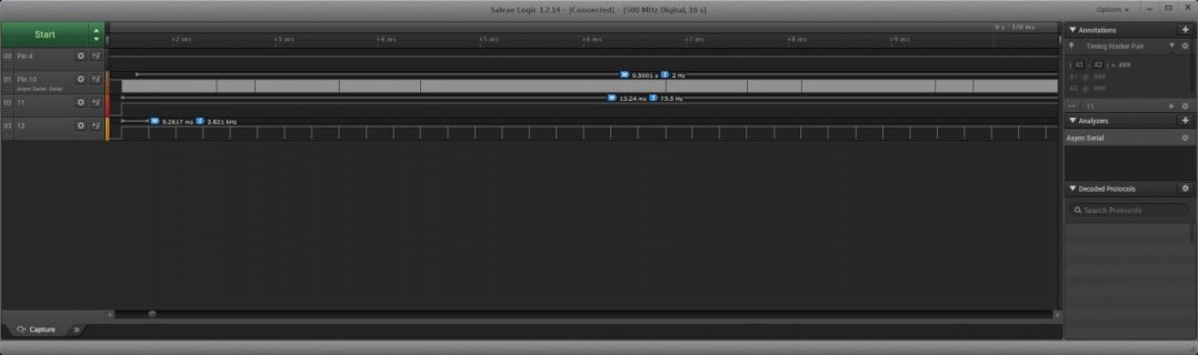

I have my logic analyzer setup to show stuff.
As you can see in the Logic output, we are not getting a full 3mbs output:
Or a closeup showing the gaps between bytes:
So It took about 13ms at 3mbs to output the 1600 characters
At 500000 it took about: 32 ms
The interesting thing was at 1.5mbs it took about 10.7ms - so less time than 13ms...

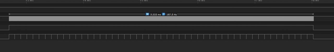

Not sure if anyone would be interested, but I hacked up the test program to output full TX using DMA... It worked on TLC, edited for T2... (Assume still works on TLC...)
#define BUFFER_SIZE 1600
uint8_t data[BUFFER_SIZE];  // larger buffer
#include "DMAChannel.h"
DMAChannel dmaTX;
#ifdef HAS_KINETISK_UART0_FIFO
#define C2_ENABLE    UART_C2_TE | UART_C2_RE | UART_C2_RIE | UART_C2_ILIE
#else
#define C2_TX_ACTIVE    C2_ENABLE | UART_C2_TIE
  while (!Serial && (millis() < 2000)) ;
  Serial.println("Test Start");
  Serial1.begin(3000000);
  pinMode(2, OUTPUT);
  pinMode(3, OUTPUT);
  for (uint16_t i = 0; i < sizeof(data); i++) {
    data[i] = (i & 0xff);
  // Try to setup dma channel
  dmaTX.disable();
  dmaTX.destination((volatile uint8_t&)UART0_D);
  dmaTX.attachInterrupt( uart0_dma_tx_isr );
  dmaTX.interruptAtCompletion( );
  dmaTX.disableOnCompletion( );
  dmaTX.triggerAtHardwareEvent( DMAMUX_SOURCE_UART0_TX );
  UART0_C5 = UART_C5_TDMAS; // enable DMA on TX
  Serial.println("End of setup");
void uart0_dma_tx_isr() {
  digitalWriteFast(3, !digitalReadFast(3));
  dmaTX.clearComplete();
  dmaTX.clearInterrupt( );  // You need to clear the interrupt to do again later.
  dmaTX.disable();
#ifdef KINETISK
  UART0_C2 = C2_ENABLE;
  uint32_t start_time = millis();
  // We wish to output 1600 characters.
  digitalWriteFast(2, HIGH);
  dmaTX.sourceBuffer( data, sizeof(data ));   // May want as sourcBuffer...
#ifdef KINETISK
  UART0_C2 = C2_TX_ACTIVE;
  dmaTX.enable();   // Start a transfer
  digitalWriteFast(2, LOW);
  // quick and dirty..
  delay(500 - (millis() - start_time));
Output Took 5.33ms on both TLC and 3.2 at 3mhz, the time that the setup for the DMA took about 1us... Have interrupt that shows when then dma output is almost complete... I mean almost as the dma interrupt is for the last byte to be put into the output queue, not when it actually output is fully output on the TX pin. On TLC that is about one character time, where as with T3.x (Serial1/2), it is the buffer size or 4 bytes...
