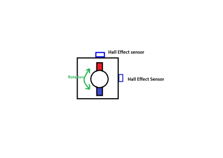

I got another question for Paul about encoder library. Since i expect that my project might experience power downs from time to time, On the start up in approximately 94% of cases the encoders will read (Hall sensors will start in pull up state unless magnet is directly under it, which you can see from image doesn't happen very often )
1 1 . Now depending on the actual position of the magnet in relation to sensors i might miss up to 0.75 of a rotation. So my question is is it possible to pass up the last state to the Encoder library so it will have a same info as it did before power down? I know the design of encoder "Wheel" is less then ideal but i had to retrofit it on the existing motor and thats the best i could do to fit in there to get close to 90 degree phase.
This is the sort of question which really depends on the meaning of "possible". Certainly this is possible with some amount of work. But perhaps that will be more than you wish to do?
First, you're going to need somewhere to store this data. The 2 basic choices are EEPROM and battery backed RAM. EEPROM has a limited write endurance, and the write speed is slow, so you really can't expect to write every encoder change to EEPROM. If you go the EEPROM route, you'll need to build hardware that detects power loss and gives you an early warning interrupt. Then you could back up the data to EEPROM right before the power fails.
Writing to RAM is probably easier, since it's fast and you can write the RAM an infinite number of times. There's no need to build circuitry for early detection of power loss. You will of course need to add a coin cell to the VBAT pin on Teensy. There's a special 32 byte area for storing battery supported data. The RTC startup uses the last 4 bytes. You could use the other 28 bytes to write copies of the stuff you want to back up.
If you want to get the internal state from the Encoder library, then you'll have to do even more work to get it to return that data. But maybe just the 32 bit count is enough? Then you just read the count at startup and initialize the library.
