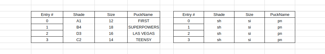

I have a project I am working on, I have all the hardware done and made I just need some help with the code, I have a custom keyboard(uses standard ps/2 output to teensy) and an Adafruit display that I can use to display the information I have in the database, what I need help with is the main code, I am not looking for a handout but code suggestions and help to make the libraries communicate would be so helpful.

I want to be able to make a new entry by invoking the createRecord(); function like so:
createRecord("A1", "12", "First");
with the "A1" coming from a keypress in response to a dialog on the display(not really the problem), "12" from a keypress in response to a dialog on the display(not really the problem), and "First" coming from the user input.
Ultimately the final argument in the code will look like:
createRecord(sh, si, pn);
with sh, si, pn all being strings to be added to the database entries(variables that are recieved as keyboard presses and converted to the approprate variable IE: 1 from the PS/2 keyboard would be converted to A1 and sent to the sh variable). I need the database to make an entry like: (click to zoom)
This is exatctly like a .csv but on teensy/arduino, this can also be seen on the
bit on line 33.
Any help would be awesome! Thanks again to anyone willing to take a look.
struct newPuck {
int shade;
int size;
int puckname;
