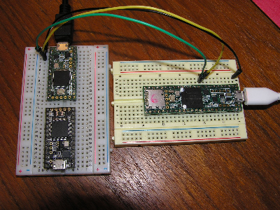

I am new in the teensy world. I am trying to communicating a teensy 3.6 with e teensy 3.2 via serial port. For teensy 3.6 I am using Serial3 port and for teensy 3.2 I am using Serial1 port. Here is the code:

Your timerFlag variable needs to be volatile.
Double check your hardware. 3 wires are needed. Connecting same-named signals together, as you would do with SPI or I2C, is a common mistake with serial. Each TX needs to connect to the other side's RX pin. Don't forget a GND to GND wire.
On both these boards, Serial1 & Serial2 clock from F_CPU and Serial 3+ clock from F_BUS. The max baud rate is their clock divided by 16. So you might actually have a higher maximum if you underclock Teensy 3.6, and use Serial1 or Serial2, possibly all the way up to 6 Mbit/sec. At such high speeds, usually RTS/CTS flow control is needed. Using Serial3 on Teensy 3.6 limits you to 3.75 Mbit/sec, if using the default 60 MHz F_BUS.
Thank you for your cordial reply. I have just checked all connections. They are okay... Any other possible bug that may cause communication failure?
Did you add the volatile to both programs and reload them?
Are both Teensy board plugged into a computer? As they both wait on while (!Serial) ;
Not too worried about the whiile (!Serial1) as these always return true.
With apps like this I would put in something like: Serial.println("Setup Complete");
At the end of Setup just to make sure you get there...
What exactly are you seeing? Does your T3.2 program ever receive anything?
Again check wiring... Also send pictures of setup.
Make sure you actually have connections between the two boards. Have seen more than once
where some one puts the Teensy on a breadboard and does not solder the pins to the Teensy.
your sketches worked for me. I added volatile to timerFlag, and increased timer to 200000, and i removed the Serial.println("master'") to keep from overrunning the monitor output. I hooked T3.1 pin 0 to T3.6 pin 8, and pin 1 to pin 7, and GND to GND. You need a monitor running on both boards, or get rid of while(!Serial); I also blinked pin 13 with digitalWrite(13,!digitalRead(13)); in if (timerFlag) block to verify timer was firing.
