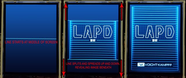

I'm now at the point where, rather than simply flip between the pages, I want to add a bit more of an elaborate visual transition. I am... not feeling particularly smart here.
Here's an example of what I would like to try for this start screen:
And here is where I start running into problems. My first thought was "just use two fill rectangles, one on the top half, one on the bottom... then redraw the image, and draw the fill rectangles again, sequentially moving them up to the top and bottom edge respectively." This is obviously not a workable solution, because the end result is something that flashes and strobes the whole screen with the full graphic and then the over-written one.
It is at this point my digging through the internet starts to suggest maybe I'm looking for some kind of frame buffer, so I can draw everything virtually and only update the changes. I have no idea how to go about doing this, and would really appreciate guidance. I looked through the "DemoSauce" example, which seemed to include screen wipes and other transitional animations, but it is a magnitude beyond what I can understand at my level of coding and there's not much in the way of commenting for me to follow to try and slog through it.
The other approach, which I'm still trying to figure out, would probably be to dim the backlight all the way off, draw the visuals onto the screen, then use the readRect() function to try and capture the screen data into single-pixel-height, full-screen-width arrays, then fillScreen() my background color back on, turn the backlight on, and use the writeRect() function to sequentially draw the graphics back onto the screen from the middle out. This feels like it would be enormously inefficient, assuming I can get it working right? And having to dim the backlight to hide it doesn't seem effective for every page transition I'd want to do.
Is there a better/simpler/smarter way to approach this that doesn't involve me totally rebuilding the UI drawing functions I've already come up with? It kinda feels like I'm looking for a way to have the 'end goal' screen data in memory work my way towards it, which sounds like the buffering approach, but I don't know how to implement that.

It occurred to me that I was making this way harder for myself than I had to!
The draw clipping functionality by itself was enough to get the job done.
  int lineHeight = 10;
  for(int i = 0; i<=ui.screenHeight/2; i = i+lineHeight){
    //draw upper
    tft.setClipRect(0,ui.screenHeight/2-i, ui.screenWidth, lineHeight);
    ui.startLAPDScreen();
    //draw lower
    tft.setClipRect(0,ui.screenHeight/2+i, ui.screenWidth, lineHeight);
I was struggling with the flickering before I realized there was no reason to be redrawing over the existing areas at all when I could control the drawing boundaries. Instead, I just have to do two diverging clipping regions, and fill in only those sections as I progress through the loop.
