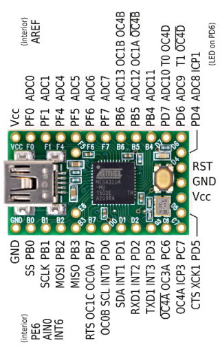

I have an app which uses 2 ADC channels on differnet Ports because of layout linitaions. Reading channel 1 from Port F on Pin PF1 works fine, but reading channel 11 from Port C on Pin PB4 returns garbage.

As the forum rule suggests, you need to provide a sketch that someone could actually run and test. There are no ADCs on Port C.
You should use analogRead() not adc_read(). The mux values for adc_read() are not linear. See https://www.pjrc.com/teensy/adc_simple.zip from https://www.pjrc.com/teensy/adc.html

Thanks and sorry for wrong format, safari did not show anything about it. And I misspelled Port C instead of Port B while not copy-pasting.

Teensyduino problem solved. I had in mind the pinout and schematics from the pjrc-website and did not mention that in teensyduino the numbering of the channels is different.
Teensyduino:
teensy2 from pjrc:
sorry and thanks for your help. Channel 8 in the sketch runs fine now, but not channel 11 in the C code. Looking further.
