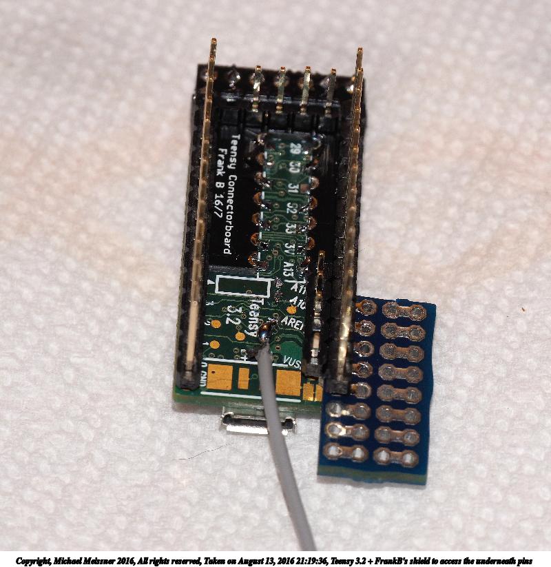

    Well Adafruit already produces a Teensy 3.2 -> feather adapter:
    If you wanted to do a 3.5/3.6 to feather you could just run wires for the DAC and program pins. Or you could use this board designed by FrankB that translates the 3.5/3.6 DAC into the 3.2 position as well as the program and Vbattery pins. FrankB also brought out Vusb, A10, A11, and AREF to that you could mount the protoshield as well in the middle (the protoshield doesn't have support for the 4 inner pins):
    Now, in terms of the 3.5/3.6 and the feather, you have to decide how you are going to mount it. The way I do it with the 3.2 (having the Teensy slightly above the feather adapter and use stacking headers for the feather pins to allow feather wings with male pins to be mounted) won't work with the 3.5/3.6 since they are longer and it interferes with the lipo JST connection in the back of the feather board.
    BTW, there is just enough room to mount FrankB's board that gives you access to the 3.2 underneath pins on the feather adpater:
    I could imagine mounting the 3.5/3.6 underneath the feather adapter, perhaps using stacking headers on the teensy and male pins on the feather adapter. This has the problem that you can't easily access the reset button, and it may be hard to get the micro-SD card out.
    Alternatively, you could mount the Teensy with normal stacking headers above the feather adapter so it clears the lipo JST connector, and use 2 stacking headers for mounting feather boards, or use male pins on the feather adapter underneath the board, and use the 2x or 3x feature doubler boards to mount the other feather wings.
