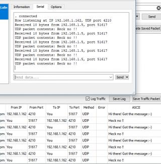

Let's talk about the ESP version of the WiFiUdp example that works if it is run on the ESP. It receives a packet on port 3333 from PacketSender and then, I have it currently set up to respond to the receipt of the packet back to port 3333. This works no problem. So basically it is sending and receiving on the same port.
For Teensquitto there are actually several cases that I tested:
1. Use AsynchUDPpacket to listen on port 3333 and send messages to port 4210 using WiFiUdp. This works and is the example sketch that I posted as an example for the library. See screenshot:
2. The second test using WiFiUDP using Teensquitto was just sending a message with and without the onDetect callback. Both cases work without a problem. Using packet sender I was able to send the message to the Teensy and it printed on the console.
3. OK Never mind the third case was adding to send a message back on the same port. Last night it wasn't working.... This morning its working. Must be another of those weird cache issues.
EDIT: Forgot a case.
The last case, which I couldn't figure out was how to do this with AsyncUDP only
EDIT2: Forgot a couple things the above test cases were all where the UDP.writes were acting as acknowledgement packets, i.e. pseudo code

Ok. Here is another interesting case.
If I create two Udp connections:
//Teensquitto setup for UDP send and receive
teensquitto Udp = teensquitto("WiFiUdp", &Serial1);
teensquitto UdpS = teensquitto("WiFiUdp", &Serial1);
and define two different ports:
unsigned int localUdpPort = 4210;  // local port to listen on
unsigned int localUdpPortS = 3333;  // local port to listen on
and the do a begin like so:
  Udp.begin(localUdpPort);
  UdpS.begin(localUdpPortS);
and then in the loop:
  int packetSize = Udp.parsePacket();
  if (packetSize)
    // receive incoming UDP packets
    Serial.printf("Received %d bytes from %s, port %d\n", packetSize, Udp.remoteIP().toString().c_str(), Udp.remotePort());
    int len = Udp.read((unsigned char *)incomingPacket, 255);
    if (len > 0)
      incomingPacket[len] = 0;
    Serial.printf("UDP packet contents: %s\n", incomingPacket);
    packetSize = 0;
    // send back a reply, to the IP address and port we got the packet from
    UdpS.beginPacket(UdpS.remoteIP(), UdpS.remotePort());
    UdpS.write(replyPacket,30);
    UdpS.endPacket();
it should listen on port 4210 and if it got a message print it to the console. At the same time it should be continuously streaming the reply packet to the second port 3333. I think that is the way it should work.
Anyway what happens is nothing is streaming to 3333. If I send a message on 4210 there is no response in the serial monitor that it got the message. However, if I switch ports to 3333 and send a message the sketch responds by printing a message too the monitor and I get a single response back to the server (packetSender).
Guess I really don't understand UDP....
you cant create more than one udp connection, its hard coded to one only, thats why whatever you do to one affects the other, they both technically link back to the same object at the source (ESP), due to the constrained connection limit on the ESP of maybe 4~5 i have omitted to add multi object support, but it can be added with a few edits to all funtions in teensy library and esp sketch...
so basically when you tell it to goto 4210 and tell the second object to goto 3333, you told the ESP object itself to switch 2 times, last one being 3333... thats why :)
Essentially, Udp and UdpS, 2 objects on teensy, to clarify, both link back to the single object Udp on the ESP. The functions have been designed to follow back to a specific object
