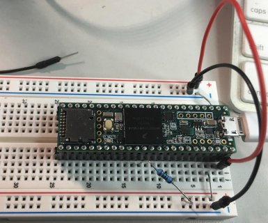

Now I've attached it to the Teensy 3.6 (image attached)

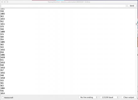

and I'm getting very noisy readings from A0 with no buttons pressed. I've even tried running a 3.3v line directly to the A0 pin to see if I'd get steady 1023 then.. Nope.
Here's what I'm seeing:
803
804
820
806
818
812
825
814
795
794
804
819
800
805
819
808
821
816
815
803
817
793
822
806
809
807
782
804

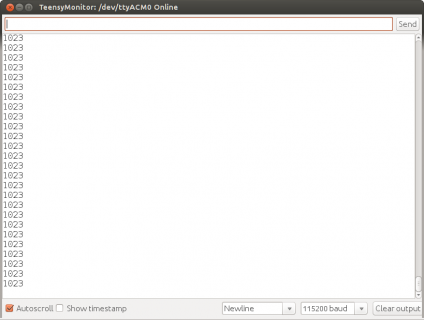

I'm running your program here on a Teensy 3.6 with a 1K resistor connected from 3.3V to the A0/14 pin.
I get a solid 1023 printing in the serial monitor.
Maybe try only a single resistor like this, just to confirm your Teensy is working.
If so, try using a voltmeter when you reconnect the buttons, so you can confirm the actual voltage at the pin. My guess is something about the hardware might not be connected quite right?

just a single resistor from the 3.3v rail to the A0 pin.. Here's my output..
Please dont tell me somethings wrong with my Teensy.. I've only had it for two weeks!

As Paul mentioned try to do it with Just the single resistor. Your picture still shows other wires connected.

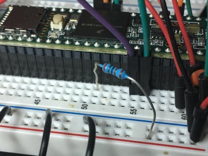

That said, I think it might be my breadboard contacts... when I tap the resistor, the values change. Is there a "best of breed" for breadboards? a trusted brand? Its not the first time I've noticed dodgy contacts with these Elegoo boards.

Something's wrong with your connections. I'd guess Teensy is probably working.
In your photo, Teensy looks like it's plugged into some sort of socket, which then plugs into the breadboard. What is that part? Maybe show us a photo of the actual pins going into the breadboard?

Having said that, I'd also guess your breadboard probably isn't the issue. Those sockets and the wires are likely the problem. Wire mistakenly plugged in the wrong spot is the most likely scenario, so I'd also suggest removing all other wires so you're testing the simplest possible case (like I did in the photo I posted....)
I'm always deeply suspicious of those "breadboard wires". They're made of the thinnest possible wire and break easily. I almost never use them. I use #22 solid wire, which you can see in the photos I often post here. It's also the same wire we put in this tutorial kit (but not shown in the photo). I believe it's Carol C2004 type.
Pleased to report that on a fresh breadboard, I'm now getting solid 1023 values from A0. Imagine my relief!
