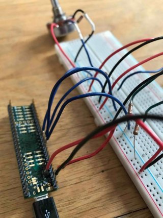

This is my first project with a Teensy so please excuse my ignorance. I have a Teensy 3.6. I have made many MIDI controllers before using an Arduino Mega so I am familiar with the process, but I have never used a Teensy before.
For now I am trying to use a potentiometer on Analog input 0, a Membrane Potentiometer on Analog input 1` and another Potentiometer on Analog input 2. (nothing is wired to Analog input 3 at the moment, but it's in the code).
I also have 16 button switches in there, and they all work fine.
The issue I am having is that I can't get the full range out of the Membrane Potentiometer. I have one wire going to 3.3V, one to Ground and one to the Analog pin. There is a resistor between the Analog pin and Ground. I am doing this on a breadboard to figure it out.
For the resistor used with this Membrane Potentiometer, if I use a 220 Ohms resistor the sensor only goes up to 82 ( in midi control change value) at the max, but when I am not touching the sensor it is at 0 (which is good). If I use a 3.3K resistor it goes up to 123 at the max and I get a solid 0 when not touching it. If I use a 4.7 K ohms resistor the sensor goes up to 124 at max, but sort of fluctuates between 0 and 1 when I'm not touching it (which is bad), and the pots on A0 and A2, who should be at 0, go to 1 when I touch the membrane potentiometer, so it is affecting the neighboring sensors.
Ideally, I would like this membrane potentiometer to go to 127 at the max, be at 0 when I am not touching it, and not affect the neighboring sensors.
Is there a way to do this? Should I add some decoupling caps in there? Is there something I can add in the code? Is there a better way to wire this?
I am also doing this with an FSR (force sensitive resistor) and getting the same problem. Hopefully there is a way around this.
The code I am using is a combination of the example code from the "AnalogControlChange" example and the "Buttons" example under USBMidi.
I have a question about this code too. Why is the Analog read number divided by 8? Like in this line of code:
int n0 = analogRead(A0) / 8;
Thank you in advance for your help. Hopefully there is a solution.

With the pots, by their nature you will never get a 0 ohm resistance through them so the fix here is a mixture of code on the input side and signal conditioning, which ties back to the divide by 8 question. The default analog read behavior runs from 0-1024 (10 bit), so the divide by 8 (3 bits) turns the signal into a 7 bit number 0-128, which I think is part of the MIDI standard.
So to get your flex pot working you either us an op amp
https://www.sparkfun.com/products/9456
to boost up the signal (probably not needed in this case because signal looks to be quite reasonable) or re write your code to take something like the 3.3k resistor and multiply by say 1.1 and then check if > 127 and if so clamp at 127. You may also need to look at the curve your resistor makes as you start to press it and do a log or power curve to get half pressure produce about 64. Doing input curves can be tricky but is a useful trick to master.

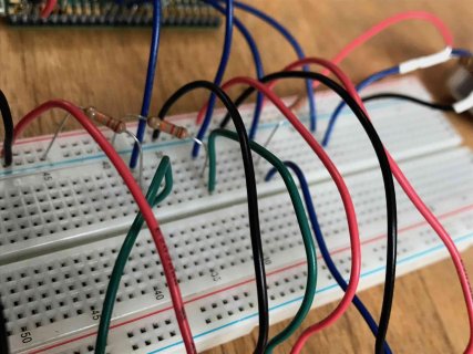

...I have one wire going to 3.3V, one to Ground and one to the Analog pin. There is a resistor between the Analog pin and Ground. I am doing this on a breadboard to figure it out.
The resistor is to stop the pin from floating as the wiper is disconnected from the pot when there is no contact (i.e. pressure).
If the value is too low most of the current will flow thru that resistor and you'll loose resolution from the soft-pot.
The example schematics for this I've seen use a value equal to that of the pot (10K Ohm).
If you're not getting the full range of output (at 10-bit resolution presumably) then you can remap whatever you are getting to 0-127 (instead of just dividing by eight) using your minimum and maximum raw readings.
      ccOut = map(pinRead,minRead,maxRead,0,127);
You may still have some issues with stability of the analog readings but I'd say this is a start.

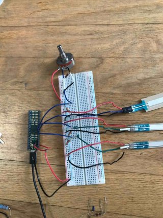

Hi everyone. Thank you for your replies. I have been doing a lot of testing with various sensors and resistors, and I will tell you what I found out. But first I want to try oddson's suggestion. I'm not sure how I would implement that in my code.
So what you are suggesting is that I change this line of my code:
to your suggestion of this:
Is this how that would look? :
int n0 = analogRead(A0)[map(pinRead,minRead,maxRead,0,127)];
thanks.
Oddson thanks for your help.
I went with this:
 int n0 = map(analogRead(A0), 0, 1023, 0, 127);

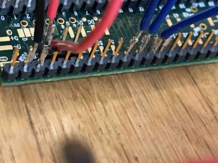

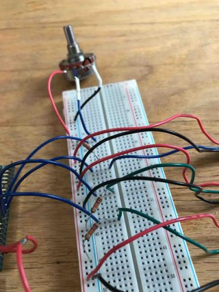

One of the behaviors I was getting, was when I was touching the top of the sensor, where I would expect 127-125, I was getting a 2 or a 3, then it would jump to 125 as I went lower. Really weird, but with mapping the value from 0-1023 to 0-127 it got rid of that.
The main problem I have to eliminate now is that when I am not touching the sensors, they are at 1. And when I touch the sensors, especially toward the top range (around 80-127) all the other sensors values go up, so the sensors are interacting with each other. I am using a 10K Resistor and the slope of the sensor values is pretty good.
So a big issue is that I need to isolate all these sensors. Is there any component or wiring solution to achieve this?
I added a 10uF electrolytic cap and two small .1uF ceramic caps between 3.3V and Ground coming from the Teensy and that helped a little. But is there any way to totally isolate all the sensors from each other?
As an experiment I also added a 10uF electrolytic cap between 3.3V and Ground going to two of the sensors and that helped a little too. Instead of being stuck on a value of 1 when not being touched, they went down to 0 (but when I touch another analog sensor they jump to 1 or 2). I would try to add the .1uF ceramic caps, but I ran out of them. Is this a good idea?
GremlinWrangler suggested an Op Amp, which I never used and don’t know how to wire. Is that a good idea and will that solve the issue?

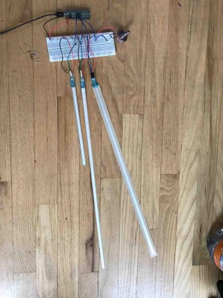

Here’s some more details.
I am using this 500 mm soft pot ( I will use 6 of these)
https://www.sparkfun.com/products/8681 which has resistance values from 100 ohms to 10,000 ohms
This 200 mm soft pot ( i will use 3 of these)
https://www.sparkfun.com/products/8679 100 ohms to 10,000 ohms
This force sensing resistor ( 2 of these)
https://www.sparkfun.com/products/9376 resistance on this is no pressure = 1 mega ohms, the more you press, the less the resistance.

Maybe if you post photos of the wiring someone could spot your issue.
Are you sure the pull-down resistors are actually tied to ground and not just to each other? That's what it sounds like from the behaviour.
Ok here are some images.
It might be hard to see what's going on so I'll explain it as well. Aref is connected to 3.3V. Coming out of each sensor is a power, ground and signal. Except for the regular Potentiometer, each sensor's signal is going to a 22k resistor that is connected to ground. The sensor signals are also connected to A0 A1 A2 A3.
Let me know if I'm missing something.
I believe AREF is only used with external references and needs to be set in code somehow... but I don't think it's a problem if it's getting supplied the internal voltage but it's not doing anything.
Is that connection why the Teensy is not in the breadboard?
Maybe smaller resistors would pull to ground harder and eliminate the problem. If it made it worse then I'd figure it was a grounding problem somehow.
I can't see where the higher voltage is getting to the other pins.
I tried it without aref and it was way more unstable, so aref helps a lot. I just figured I should use it since I've used it previously in my Arduino projects.
