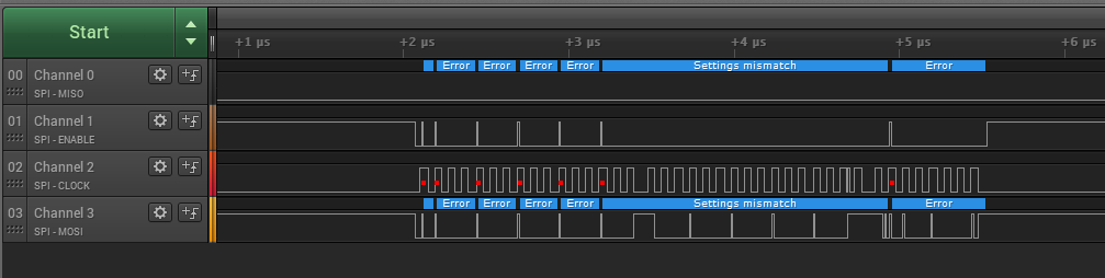

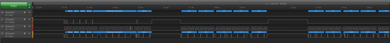

the Ethernet.init(15) will not change the value of PIN_SPI_SS, it will cause the library to use pin 15 as CS for SPI. So your print is not a meaningful test. do you have an analyzer or scope to look at SPI activity?
Okay... That's weird. The ethernet module seems not to answer on MISO.
Right now it doesn't even work on the first way (pin 10 CS). I will figure it out in the next few days.
Thanks for your support so far. In the worst case I will try to select a different TX2 pin.

Any chance the problems you're seeing are simply a wiring mistake? CS on pin 15 definitely does work.
It is sometimes hard to see for sure what your signals are doing in the Logic Analyzer. Maybe did not run the software to capture at a high enough speed.
Also as Paul mentioned, you should double check wiring. Also maybe post a picture. Pictures help to see subtle issues. Like if you are using a breadboard, are the pins actually soldered to the Teensy? That is one of the common problems we have seen. Or maybe a ground wire was not run, or maybe the wires are not making good contact.

My mistake was the nReset pin. I used to connect it to an I/O Pin to reset the ethernet module in the setup routine, which doesn't happen in my program so the modules reset status was undefined.
It works!
