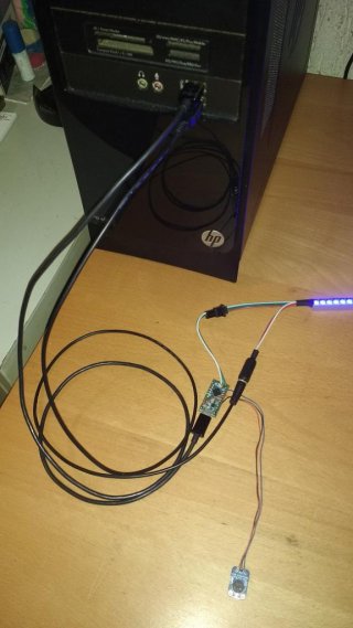

I just ran your code on a Teensy LC connected to a 144leds W2812B strip. The Teensy LC has a special output pin that drives 5V out [effectively the same as the prop shield does].
So I only had to change this line to:
#define DATA_PIN    17   // TeensyLC 5V pin
and keep the rest of the code the same.
I do not see a drop in brightness! Even if I increase the brightness to value 255, I don't see a drop.
So probably it's related to the way the strip is powered.
Here is a picture of how I powered the TeensyLC and strip.
Both the TeensyLC and strip are on a separate USB connector. Your strip is powered from the prop shield 5V pin.
Is it possible for you to power the strip from another 5V source?

Thinking it all over again, the problem may be related to the 2 strips in parallel.
With this line
  FastLED.setMaxPowerInVoltsAndMilliamps(5, 500); // power strip from USB port
you tell FastLED to calculate the max current based on one strip of 127 leds. But you do have 2 in parallel. Which doubles the current drawn from your USB port.
Could you try removing 1 of the strips?
One more remark
because I need the leds to work at almost full brightness regardless
Each RGB LED consumes about 60mA at full brightness. Having 288 leds means ~17 Amp at 5V... you will need an external powersupply.
I think your right about that. i ordered new strips just in case, and I can use them to test different power sources, which i think will solve that problem. thanks so much for your help.
