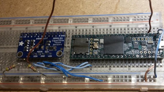

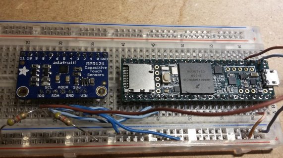

I've downloaded an arduino compatible library for the MPR121 sensor. This sensor comunicates using i2c protocol. Here are pictures of my wiring:
I have modified the code a bit compared to the original code where I downloaded this from. I changed the i2c pins to the pins 37 and 38, and I added a "Serial.println("hello world");" in the setup function.
The problem I am having is that nothing is being printed in the console, not even the hello world i printed in the setup function. here is the arduino code:

Might help to put a delay() after the serial begin ir use 'while(serial.begin(9600))' to let it connect with your windows (?) port.
Then sprinkle a few more serial.println() statements thru the code to find where it it getting hung up.
Pins 37 & 38 are SCL1 & SDA1. That means you need to use "Wire1" rather than "Wire" to access them.
I'm not familiar with this particular library (and I don't see any link to its code), but if it is designed like most Arduino libs, it likely has "Wire" written throughout its code. You would need to edit that code to change every "Wire" to "Wire1". Some newer sensor libraries offer a way to configure which Wire instance they use, but those are relatively rate. The vast majority of sensor libs are hard-coded to use only Wire, since most Arduino boards offer only a single Wire port.
Instead of Wire1, you could use pins 33 & 34, or pins 16 & 17, or 18 & 19. Those are all SDA0 & SCL0, meaning they are controlled by "Wire". I'm pretty sure you'll find everything works fine if you use those pins.
Thanks Paul, I changed every "Wire" to "Wire1" and it worked. But I don't understand the reason why there are a setSDA and setSCL functions when you just need to use Wire1, Wire2, or Wire3... kinda confusing...
