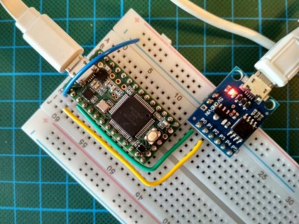

are your usb cables going to same pc? because i dont see any common grounds between both mcus..
Both were connected to the same USB hub. Anyhow, I added common ground on the breadboard as well, but the issue persists:
I forgot to mention: When the Teensy receives “Hi!” from the Digispark, then the Teensy’s LED only flashes once. When I use another Digispark as a receiver, then the LED of that flashes once per character received.

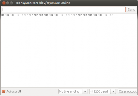

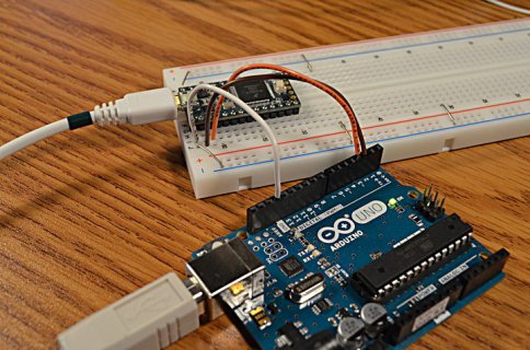

I don't have a Digispark, but I do have Arduino Uno. So I tried to set up this test using Uno.
Here's the result I see from Teensy in the Arduino Serial Monitor.
I ran the exact same code you posted on Teensy.
For Arduino Uno, I had to adapt your code slightly. Seems on Digispark the library is SoftSerial versus SoftwareSerial. I also had to change to pin 3 for transmit and 13 for the LED, since Uno reserves pins 0 & 1 for its serial port. Here's the exact code I ran on Uno for this test.
I was able to reproduce this problem. It's caused by lack of any delay when turning the LED off. What you're seeing is 3 "blinks" which run together, visually appearing to be 1 longer blink.

Thanks for all the help! In particular thanks to @PaulStoffregen for trying to reproduce the issue using an Arduino Uno, for debugging my code, and for explaining 300 baud support!
Finally, I got the circuit to work. The board that I used as sender was broken. Replacing it solved the issue.

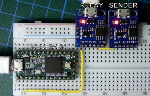

I’m back at receiving junk on the Teensy. But this time, I think it’s my code. I added another ATtiny85 as a relay:
Every time the relay receives a character from the sender, it sends it right away to the Teensy:
  if (receiveSerial.available()) {
    char c = receiveSerial.read();
    sendSerial.write(c);
    flashLed();
    delay(100);
This seems to be a bad idea. If I have each ATtiny85 communicate directly with the Teensy, then communication is clean.

You can get a Teensy LC for $11.29 https://store.oshpark.com/products/teensy-lc
There are probably lots of other options (personally I like Teensy...), but for example you can get a Robotis Open CM904A chip $9.95 (http://www.robotis.us/opencm9-04-a-no-connectors-onboard/) which is bigger and has 3 USARTS... Adafruit Feather M0 again larger and more expensive than Teensy LC...
With your code, I wonder how well SoftwareSerial works at 4800 baud on those boards...
Again with that code, personally I would change a few things, but again may not mater.

Thanks for all your suggestions! In fact I’ve a Teensy LC here. Unfortunately, three UARTs is one too few.
In the meantime, I’ve read that some boards allow reconfiguring UART pinout. The ESP32 is an example: #152 Quickie: Additional ESP32 Serial Channels in Arduino IDE (Youtube)
I wonder if there is any board where UART pinout can be reconfigured while a sketch is running. Because, that would be a good solution. While I need four UARTs, the UARTs don’t need to communicate simultaneously. It is fine for them to communicate one after another, in well defined discrete time-slots.
In fact avoiding doing too much simultaneously also solves the issue that I had with the relay. Now data is relayed only after a full package has been received. Between sending packages Hi\n, the sender pauses for a second. Excerpt from relay.ino:
