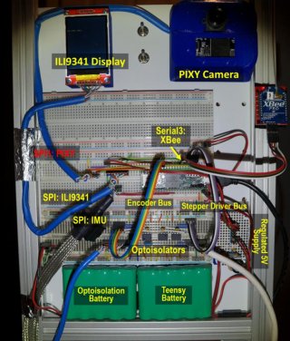

Problem solved using a separate SPI port. My crowded project required reassigning pins to access MISO1/MOSI1/SCK1/CS1, but it was well worth it. Object-detection information flow to Teensy3.6 is solid.
Image below shows the ILI9341 and IMU sharing the default SPI port, and PIXY on SPI1. If I decide to add more SPI devices, I'll have to test out a tri-state buffer because that may be easier than accessing SPI2 on the bottom pads.
I had trouble connecting to SPI1 because it's not sufficient specifying those pins. Function-calls require the "SP1" identifier. See code below:
