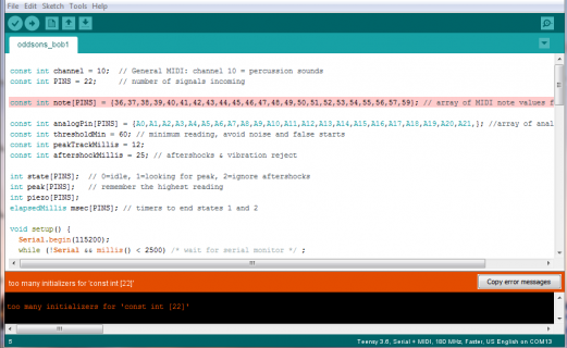

Very nearly but you have 23 elements in each rather than 21.
The space between the array name and brackets is optional (turns out) but I prefer no space.
Here is my utterly untested extension to multiple piezos:

I tried to keep to the old code a much as possible other than merging the peak detection into the main loop; even where I had issues with the existing code.
Wow Thank you! It would have taken me weeks to figure all that out, I have to wait till tomorrow to test it, I'm on a different computer. I will let you know as soon as I do. Thanks again!
Well, it just plays A0 the same as before, I tried several pins along with A0 but no sound. tested the pins with another sketch, they all work. I reduced the analog pins to 21 (A0-A20) I tried to change the no. of incoming pins to 21 and I get this error - too many initializers for 'const int [21]'. If I don't want to limit this to channel 10 can I just eliminate that line so it will use all channels?
Sorry... there's nothing magical about 21. I typed it instead of 22. You had a 23 entries in the array you had initialized to have 22 entries. I said 21 in error.
It not working is to be expected frankly... I very rarely get this stuff right on the first go and so there is very likely some errors in my code and what is working and not working will hopefully let us find them together.
For testing you may want to reduce N from 22 to 3 until you get it working.
Note that in an array declaration the size declared inside the array cannot be smaller than the number of items you are putting into it. That's what that error meant, you can't put 22 items into 21 spots.
If it only works on pin A0 that implies the problem is with getting the value into voltage.
It looks like I accidentally declare the variable after it tries to assign peak to it... I can't see that working at all (even on just A0) so lets get that fixed and try again.
I've reduced PINS = 3 with pins A0,A1,A2 active.

Thanks Oddson, I rarely get things right the first time also but I'm persistent. So still just A0, I only have 2 piezos connected right now A0/A1, I'm afraid I can't be of much help here, if this has to do with the loop going back to A0 this is beyond anything I know
ok... I'll have a look and will likely ask you to run another version, try an alternate setting or (hopefully) fix the obvious error that's eluded me so far.
...I completely misread how this code works...
I may be a bit.
Could you try this code?
I decided the thing to do was make it more like the original and restore the function call once i realized global variables would work if I passed the index value instead of the reading itself and then just replaced voltage with 'piezo'.
I also realized I could do some minimal testing with a pullup wire and some resistors to keep the analog pins from floating. So a jolt of 3.3 volts mimics the piezo transient (once it increased all the timeframes by 10 fold).
So this is a bit tested and it at least isn't pumping random garbage MIDI any more.

I new you could do it! I only have 2 piezos hooked up but they play 2 different notes with velocity. I can tell you there are many people still looking for a sketch like this. This can be used for several different instruments instead of just one. Ableton has some nice percussion instruments like brushed bells, marimba etc. I have 1 more thing i'd like to get with you about should be fairly simple but not tonight. Put your name on it, and thank you!!

I just went through all the pins, they all work, I don't understand why this works, - const int PINS = 3; but when I have 23 pins /23 notes I have to change that no. to 24. It's not important I just don't understand.
Array size and item count should match, but you had one too many for the 22 spots available in your earlier code.
If you initialize the array larger than the item count it will still work. You just don't call on the zero values it fills in anyway...
Still, count your values manually to double check
But if you give it more values than you have sized it for you get the error you quoted
screen shot.PNG doesn't enplane this though
