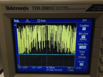

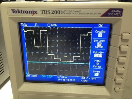

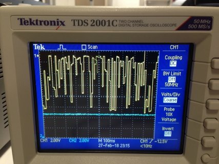

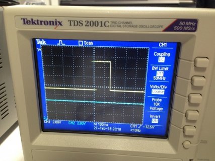

The problem was originally posted here: https://forum.pjrc.com/threads/49799-DAC-on-Teency-3-5
But at that time I was thinking the signal was noisy due to some problems in the circuit or with the grounding.
Currently I have tryed to change the "delay" in the void loop and those are the signals (please see attached pictures) I get from the scope with different values of the delays. I can not understand why the signal does not mantain a shape of a sin wave but oscillate so much.
By increasing the delay the signal doesn't look noisy so I am quite sure the problem is not in the hardware connections but in the software.
What is there wrong in the SPI communication?
Is there a timing problem?
I would really appreciate if you could look into this matter.
Thank you for your help. :)

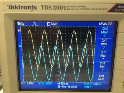

Thank you very much Theremingenieur!! :D :D
This solves my problem!
I have added the following line at my code and the "begin" and "end" transactions lines:
SPISettings setMAX532(2000000, MSBFIRST, SPI_MODE0);
Bytes were sent in the correct order.
Here is the final version of the code that allows to obtain two sine waves with a DAC MAX 532 from Teency 3.5, and the image of the resulting signals on the scope.
