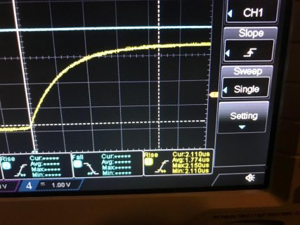

I looked at the waveforms on a scope and the falling edge was solid, but the rise time using the internal pullup was 4us. I reduced this to 2us with external 5k pullups. This reduced but didn't eliminate the dropping completely.

I have a very long-shot suggestion. Is it possible that the level at which a RISING interrupt is detected is less than the level which determines whether digitalRead sees zero or one? If so, perhaps when the rise time causes the interrupt, the digitalRead still sees the level as LOW. They are close enough that things usually work but very occasionally things go wong.
Just as a test try adding a 2 microsecond delay before digitalRead.
Pete
IMNSHFO, it's not the Teensy's fault. When I wrote my encoder class, I found it reliably working. I had even added code to alert when a new transition would happen while one interrupt was still running which never happened. I second el_supremo's idea that the rising time of your encoder is perhaps not optimal - on a Teensy running at 120MHz, 2us are 240 CPU cycles... If you cant't fix it by adapting the pull up resistors, use external schmitt-triggers.
I didn't know there was a hardware decoder in there. I've designed a couple myself in silicon back when I was young and feature sizes were counted in microns. Thanks.
Thank you el_supremo and Theremingenieur. I will make progress tonight.
Sleep is good. It clarified what was not clear the night before.
Reading the data bit following an interrupt is always going to present some race hazard for some timing model and the noisy input transition is one way to poke it badly.
So: I'll be adding a schmitt trigger on the inputs and removing the bit read and just using the transitions to move me around a 2 state quadrature state machine. I'll also try the HW decoder, but I want a SW version for portability.
Reducing the pullups to 1K from 5K seems to have cleaned it up and it's now catching all the transitions and staying close to the same point as it's repeatedly rotated through multiple 360 rotations. I had no schmitts in my parts box, so it'll be a few days before they come in the mail to clean it up properly.

The Schmitt Triggers arrived. I've added a local 5V linear regulator and Schmitt triggers on the inputs from the encoder, along my my more robust edge detection state machine code that doesn't have timing hazards and the encoder is working perfectly and the edges all look clean on my scope.
