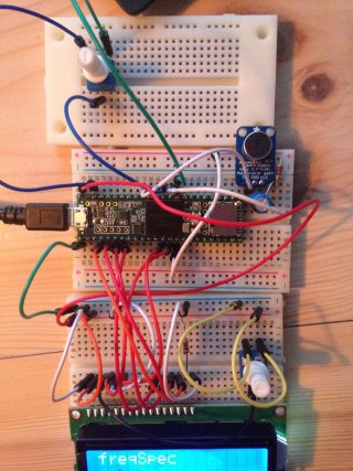

After thoroughly reading relevant threads in this forum I still have a lot of questions regarding a project I am doing right now (part of a MA thesis in Design)
I am trying to get following setup to work and have a couple of issues/questions i ran into using the Teensy Audio Library:
Hardware:
Teensy 3.5
MAX4466 Microphone
LiquidCystal Display (as a substitute before using steppermotors with TMC2100 SilentStepStick, and Nema17)
Potentiometer
Description:
I would like to separate frequencies of different surroundings and use the values of the FFT after conversion into dB values to control (for now) one Steppermotor. My thought is to use a potentiometer to scroll through the FFT bands and select a desired one to see whats is going on there. I started with the SpectrumAnalyzerBasic from the Audio library and made some changes since I don't own an AudioShield (yet :))
Issues:
0. Is it possible in general to drive a stepper motor and run FFT together from one Teensy? If so, does it need to be sequentially or can i do the fft while the stepper is running (Accelstepper and TeensyStep seem to support imediate return)

2. When adding the potentiometer
sel = map(analogRead(14), 0, 1023, 0, 15);
  Serial.println(sel);
the Arduino IDE compiles and uploads it but nothing is printed to the Serial monitor and it seems the microphone and the display stop picking up and displaying the sound. It somehow works if putting this snippet at the end of the loop but then the mapping function wont work, I even got very high values (around 65000) when turning the Pot. I have tested the same setup in a separate sketch where it functioned flawlessly.

Everything's easier with the Audio Shield.
Got it to work with PWM and dc motors.
The only thing that's left from the issues above is the correct translation of the FFT values into db...
You can't use AudioInputAnalog and analogRead() in the same program. Both try to access the same hardware, causing a conflict which crashes your program.
Thanks. I eventually found the threads discussing this ADC conflict. The AudioShield was indeed the magic wand that helped solving the issues.
