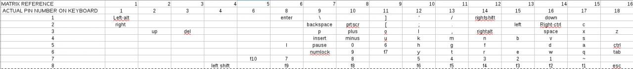

Having some trouble figuring out a keyboard matrix
number-g
I've been following this guide (http://www.instructables.com/id/Make-Any-Vintage-Keyboard-Work-With-a-Modern-PC/) to convert an old laptop keyboard to USB using a Teensy LC.
I've managed to trace and record the keyboard matrix into a spreadsheet (here: https://pastebin.com/NL66Zg2v) but the configuration of the matrix that I have is a bit different from the one on the above guide.
The matrix is 12x12 but isn't symmetrical/sequential: pins 1,2,3,4,5,6,7,8,9,14,15,18 appear to be the rows, and pins 10,11,12,13,16,17,19,20,21,22,23,24 are the columns as opposed to the 8x16 matrix in the above guide which just uses pins 1-8 and 9-16 in sequential order.
I'm confused about how to visualise this and implement it in the code example from the above link. Also I am generally confused about how to "pad" the matrix in the code.

The zeroes are my attempt at making sense of how to pad it out to make 12 items on each row, and it doesn't work. Also, note the changed rowPins and colPins to reflect my pinout. Not sure if this is correct.

If it were me, I would probably try to make an updated spreadsheet with two dimensions showed.
That is have a set of rows going down for the pins: 1-9
Then setup a set of columns with each unique value that you have in the 2nd numbers, and see just how many columns you need.
Looks like some of the special keys have their own setups (shift, alt....), which I would probably handle seperately.
Then once you know how many unique rows/columns you need, you should be able to assign pins on the LC to each of these...

Thanks for your reply,
I realised that I was reading the data in my spreadsheet the wrong way round (that and that some of it was actually wrong in the first place) and that I am actually dealing with an 8x16 matrix.
Pic: https://i.imgur.com/qRb7Tss.png
I figured out how to lay it out properly in the code:

Thanks again for your help, I appreciate it.
It compiles!
But I think I had my matrix the wrong way around (16x8 as opposed to 8x16) as it was going kind of berserk until I changed to 8x16. Now it compiles but doesn't send the right keystrokes, I am assuming due to my pinout in the code. I don't quite understand how to correlate my matrix with the pins.
Here's what I have:
How do i reconcile the fact that pin 8 (for example) on the keyboard is used as both a row and a column? (see picture).
byte rowPins[ROWS] = {5,7,19,20,21,22,23,24}; //connect to the row pinouts of the keypad
byte colPins[COLS] = {1,2,3,4,6,8,9,10,11,12,13,14,15,16,17,18}; //connect to the column pinouts of the keypad
Am I even in the right ballpark with this or am I totally misunderstanding something?
EDIT: Come to think of it, 18 is the highest pin in use at all, there were 24 on the board so I connected them all but I guess I don't even need the other 6? Or would they be used for something else while the keyboard is operational?
Sorry hard for me to know how your keyboard is actually hooked up internally. Yes having Rows/Columns using same pin I would believe would be problematic.
Again I have not used this library, but long time ago rolled my own using 16 button keypad, plus hard wired in an extra row of buttons.
Scratch that, my matrix is still a little bit off. My multimeter probes broke while I was halfway through it the first time around so I have been using whatever was to hand, gripped with croc clips and must've made a few mistakes. I'll update this when I get a bit more time to re-check everything.
