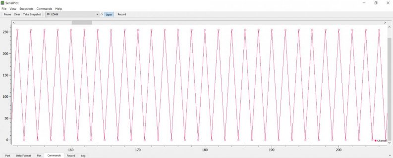

Hello everyone.
I am working on a teensy 3.6 based oscilloscope. I know that it will be limited but in the near time I am not going to need anything more than the 1MHz range.
I already got a working code, which gives about 800KSps:
(problematic serial function in the bottom)

With arduino's serial monitor the output is a fast sequence of mirrored ????? symbols. (the ADC input is tied to 3.3V)
However when I started working on a PC plotting software (in C#) the output was this sequence:
255
0
255
0
255
and so on...
After getting tired of programming by myself, I turned to a free, open source software called SerialPlot.
The result there is the same:
If I tie the ADC input to 0V the output is jumping between 0 and 1 (no caps used, so I know it's okay that I get 1).
Same thing happens with a 1/2 voltage divider, output is changing between 0 and ~127.
The SerialPlot software settings are:
- No parity
- 8 bits
- 1 stop bit
- No Flow Control
Encoding:
Simple Binary
- N.O. Channels: 1
- Number type: uint8
- Endianness: Little Endian
Do you know what the problem could be? Encoding incompatibility? bad sketch code?
Thanks in Advance,
128ITSH
1. you have set the ADC to 8-bit, but your buffer1 is int16_t -- try setting that to int8_t.
2. your Serial.write() is trying to write uint8_t, so it will write one byte of the 16-bit buffer1 (high order byte will be 0), then 2nd byte of 16-bit word will be the value of the ADC (255)
3. Serial.wite() writes binary data, so on the IDE monitor output will be gibberish characters. You could use Serial.print() to print the values out as ASCII, e..g "255"
4. it's poor practice to print inside ISR's
5. there may be other problems ... i haven't actually run your sketch

Since the ADC is basically a unipolar 16bit device, it will always read uint16_t values and write these to 16bit registers, even if you select a lower resolution. Only after pulling them from the ring buffer, you might convert, or map these to signed 8bit values. What you are doing is printing bytes from the 16bit values, but since these are only filled with 8bit, every second reading gives a zero. Normal.

currently I can't find a way to convert the whole uint16_t[] buffer to a uint8_t[] buffer without the unneeded byte. However changing the encoding of the SerialPlot software to 16 bit values gets around this problem, however it is not efficient to write x2 more data than the actual readings so will be happy if there's a way to convert the whole 16 bit buffer to an 8 bit buffer while discarding one of the bytes without looping through the whole buffer.

To me, there seem to be only very few options to "convert" the buffer content without an additional looping in code. The "Gold standard solution" would be to modify the DMA transfer inside the ADC lib to transfer only the lower byte into the buffer which could then be set up as 8bit type. But fiddling around with other people's code without accidentally breaking important functionality is not everybody's cup of tea. But I could imagine a kind of "compromise" to use a DMA trick to let run that without eating too much CPU cycles: Set up a second buffer, this time uint8_t[] and let another DMA channel transfer the data from the first to the second buffer, always skipping one byte which can be set up in the DMASettings for that channel. This second transfer could be triggered from the first DMA_isr.

Maybe it would need to change to something like:

It may not work... There are other places as well in the code to check like the increase method... Also you would also probably need to change the data types in the class...
This is truly an easier approach.
Just had to change almost all ADC-result-related-vars data types to int8_t, and tweak all of the duplication problems by changing the class name to RingBufferDMA2 and replacing the files in the library. This works and gives me only data, without 0's. the received sample number only reaches about 90k, but I believe it's the SerialPlot software bottleneck (256000 max bandwidth, and most other serial plotters don't go higher), since arduino's serial monitor keep on showing about 790ksps. This probably means I will have to make the plotting software myself... I'm gonna have a lot of headaches, but learn a lot.
