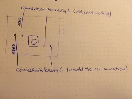

If it's getting really hairy and nothing will work, I would have to connect the two after all (but I would hate to do that, as it is kind of defeating the purpose). Would it be possible to add wires to (for example) the NUM button, and connect it to the second teensy as well?
Like this: ( [O] is the button, | are the wires )
I think, if I don't want to go too deep and as I need this working in time, I will have to connect both sides (at least two buttons, one from the left hand for the NUM key and one from the right for a "SHIFT" key, to make these work on both hands' character keys).
So my question is, would it be possible to connect one button with two teensys?
I tried to google a bit, but I did not really find anything.
I would connect the buttons just like the drawing above, using the same way of wiring I used for all the other keys, but two times (one to one teensy and one to the other).
I just don't know if I could get into trouble doing this, and before I do I would like to verify, that I will not burn anything by doing it.
Again I am no EE type...
But I would think you should be able to connect same button to both boards... Obviously best if the switch has two sets of contacts, like I think you are showing.
My guess is you could probably also get away with connecting the connection of Teensy 1 and Teensy 2 together, have both of them configured as INPUT_PULLUP and have a common ground.
But hopefully a more EE type person could answer better.

I connected the buttons to two teensys and combined the grounds.
It works fine, I can now use the NUM key for both hands (yippieh!).
