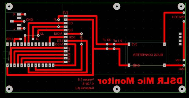

All,
I'm making good progress with my mic monitor for my DLSR--this device will fit between my lapel mic and my Canon 7D, so i can have dynamic level control. So far i've got working
1. LCD with touch
2. Audio shield
3. FFT
4. slider like gain contol
5. options screen
6. low and high pass filters (but no clue how to set the parameters)
I'm getting some noise though (hiss and a very faint sound like a sci-fi phaser gun). i'm not sure if it's a bad implementation of the audio objects of if I need to add some filtering which I'm trying but not really working, also i'm powering my unit from my PC USB.
Regarding filters, how do you set them
1. if I want to remove everything below say 60 HZ, i use a high pass with frequency at 60 correct?
2. if I want to remove everything above say 10000 hz I use a low pass with the frequency at 10000 correct?
3. how do you disable the filters in code, currently i'm just setting the filters so the won't filter anything--probably not the right way?
I'm not sure what stage and Q really do, right now i'm just swapping values until my noise gets removed--which it's not
thing.setLowpass(stage, frequency, Q);
Anyone wanna look at my code and see if there are any glaring issues that will cause noise? I can strip my code down to the bar min if needed.
  This program is a microphone montitor for a DSLR, it will sit between a mic and DSLR input so the user can control the mic levels and see the
  levels.

All,
Before i etch a PCB board for my "DSLR Mic Monitor" do you think i need any ground traces around other vital traces? The audio board will be soldered directly to the T3, and there will be very short jumpers between the 3.5 mm mic jack and the audio board.
Components i'm using
T3
Audio board
Buck converter (powered by a 9V battery)
2.8 inch touch display
3.5 mm audio jack
The board will be a single sided only as i'm a garage DIY kinda guy and can't do double sided.
My main goals are to reduce noise as much as possible.
Think this will work regarding minimizing noise?
Thanks in advance.
Why don't you use an Lithium-Accu instead a Buck-Converter? The noise will be reduce and the battery-life is longer as a 9V Battery.
You made a mistake on your board-layout! Teensy Pin 3 is a output not an input, change 3,3 V to Pin1 Vin!
Josh911, I tried connected a USB battery charger directly to the Teensy, and no difference in hiss. I did add a DC blocking cap (0.1 uF) to the mic and it eliminated the alien sound, but I still have the hiss.
oddly if i set the gain to 0, i still hear hiss in the audio output.
mixer1.gain(0, 0);
mixer2.gain(0, 0);
Thoughts?
