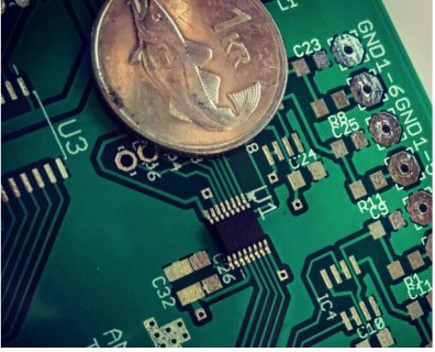

Hi all
So I'm copying code from a PIC project - so I have the data how to talk to the MAX.
Nothing working ;)
As I have this now soldered my brand new PCB fresh from China - I can't change anything, but I have confirmed the pins are connected correctly
With two exceptions:
SCK is on pin 14, not 13 - was hurrying to get the PCB design out, saw that the LED is connected to pin 13 - so I picked the alternative pin
CS was put on a pin 10 - that should be ok
then I have a input pin that should go low when conversion is done
here is the code - please let me know if you see something obvious - else I need to get a logic analyzer and see what is going on
And note this is the first time I write directly to a SPI device, just been using libraries for LCD etc.

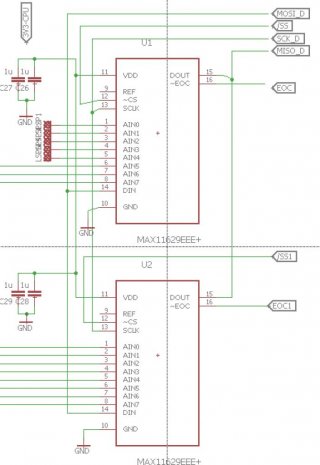

Also without any other additional information, like how all of the pins are connected to the chip, can only guess. Schematic?
I confirm just with ohm meter that the connections are
like they should be

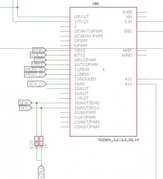

Here are screen copies of the relevant parts
I think I got the in/out correct -
I was super excited in the continuity test when I found that two pins where bridged. But that did not change anything.
Hoping this would be something obvious. I put the pin 14 as input and shorted 13/14 together for the SCK - I see the LED light up if I loop fast so the chip is clocked.

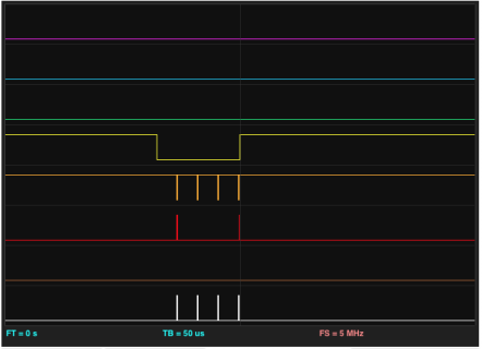

well, I think it's confirmed with logic analyzer that the devices are talking
I put a interrupt on the EOC pin and it triggers.
It seems that I'm not correctly enabling the MAX to continuously make measurements - so when I call the init again and again I get the EOC signal
So I'm going to go over the setup of the MAX chip to see where my error is.
thanks again !
