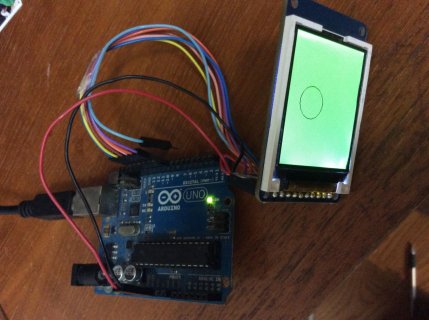

I am trying to write to a Adafruit TFT ST7735 with a Teensy 3.2. Using an Arduino Uno I have been successful but no luck with Teensy. Here is the code that runs ok on Arduino:

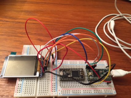

Instead, put a little effort into a few good photos to actually show us how you connected the wires. I know you said you already double checked the wiring, but we get these questions all the time and the problem almost always turns out to be an error or misunderstanding in how to connect the wires. We're pretty good at helping, but only when we can actually see how the wires are really hooked up.
I am also confused on why it is showing duplicate liebiraries for ili9341_t3.h? ... When you are using #include <Adafruit_ST7735.h> ?
Also pictures really help! Example is this in a breadboard? If So are the pins soldered to the teensy?
Also might help to know which Adafruit display...

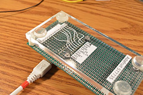

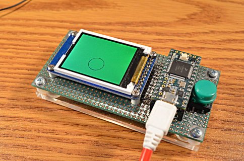

FWIW, i have successfully used this ST7735R, https://www.adafruit.com/product/358, with T3.2. I have a mandelbrot sketch and an audio FFT spectrum analyzer sketch.
i will try your sketch later tonight ...
EDIT: Your sketch (unaltered) worked on my display -- a black circle on green background. 3.3v, gnd, SPI (10-13), DC 9, RESET 8, 3.3v to LITE. IDE 1.8.4/1.40
Works for me.

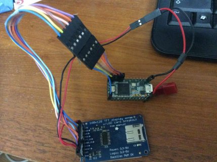

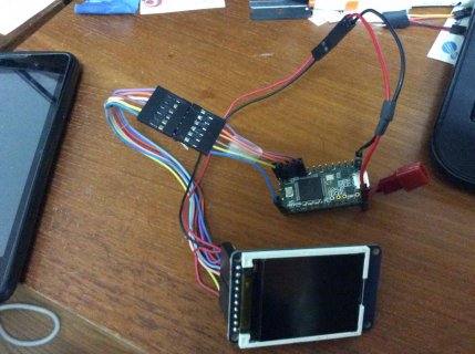

BTW, I am using another Teensy 3.2. All the pins on the Teensy are soldered in. I recrimped the short adapter plug coming from the Teensy SPI ports. The Teensy power jumper on the back is open so I am powering with a 5v source (red connector on right). On the connector at the TFT, I have a jumper from +5v to Lite. Here's another picture of setup.IMG_0018.jpg
You might try updating your Arduino IDE and teensyduino.
It looks like you have 6 data wires (pins 8-13) coming from T3.2, but in the next connector you have 7 wires ??? you should leave CARD_CS unconnected.

I have the 6 data wires and just had the SD card CS wired but not plugged into the board. As I mentioned, I can plug this right into an Uno and it works perfectly. I also ran the "Blink" program on both Teensys' and they work fine.
