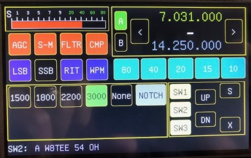

Paul: I have been tracking a "bug" for three days now (I'm not that good) and it concerns writing/reading EEPROM. I have a union:
union  {
  byte array[6];
  int num;
  long bigNum;
  float fp;
} myU;
that I used to shove values set either as defaults or by the user into EEPROM for retrieval on startup. I have this code:
  myU.num = cwSidetone;                           // CENTERFREQCW Default sidetone and center frequency for CW narrow = 700
  EEPROM.write(offset++, myU.array[0]);
  EEPROM.write(offset++, myU.array[1]);
where cwSidetone is an int with the value 700 (0x02BC). At this stage, offset in an int data type with the value 421. On startup, I read the EEPROM map with:
  myU.array[0] = EEPROM.read(offset++);                   // Default center frequency for narrow CW = 700
  myU.array[1] = EEPROM.read(offset++);
  //myU.array[2] = 0x00;                                  // NOTE: Commented out...
  cwSidetone   = myU.num;
  cwCenterFrequency = myU.num;                            // Set to center freq of filter, too.
  Serial.print("cwSidetone = ");
  Serial.println(cwSidetone, HEX);
  Serial.print("*******************in Read()  myU.num = ");
  Serial.print(myU.num);
  Serial.print("    array[0] = ");
  Serial.print(myU.array[0], HEX);
  Serial.print("    array[1] = ");
  Serial.println(myU.array[1], HEX);
The offset is correct. If I leave the commented-out assignment for element 2 of the array, the value is 0xD902BC (14222012) which is in Hz and, so, is probably higher than most people can hear. If I uncomment the line that zeroes out the 2nd element of the union member array, the correct value is returned. I tried to reproduce this with a short program, but couldn't. My current program compiles to 180476 bytes of flash memory, and 30224 bytes of SRAM on a Teensy 3.6. I do know that the 0xD9 byte is an artifact of an earlier conversion using an unsigned long for a ham radio frequency. Still, I am puzzled why this bug works the way it does. Anyone: Any thoughts.

Michael: Actually, I'm just using the union to abstract from the Endian problem, if any, across platforms. Another discovery today: using this to work with the same union as above:
  myU.array[0] = EEPROM.read(offset++);                  // Screen calibration constants
  calibratedXLo = myU.num;
where calibratedXLo is the low X pixel value for a touch screen. I read three more similar coordinates, all of which pertain to a 800x480 display. I'm getting values in the millions. However, if I add one line:
  memset(myU.array, 0, sizeof(myU.array));
I get exactly the correct test values. Since no value needs more than two bytes, and the fact that I only do the memset() call once at the top of the four calls, I am perplexed as to what's going on. Again, I cannot duplicate it with a small test program.

defragster: Thanks for noodling my problem. I do have one interrupt in the code which works in conjunction with a rotary encoder, but that interrupt does not come into play with anything in the EEPROM memory space. Also, the relatively short ISR only has one global variable and that is defined as volatile. I have used "scaffolding" code for my debug statements, like:
#ifdef DEBUG
Serial.print("calibratedXLo = ");
Serial.prinln(calibratedXLo);
so when I comment out the #define for DEBUG, the debug statements are not compiled into the executable. No change in performance, however. I have inspected offset and it is consistently correct.
Alas, I am not able to reproduce the behavior in a short "postable" sketch. As I mentioned earlier, this is a fairly large program--the largest I've worked on for a µC--that controls this 5" TFT touch-screen display:
I'm starting to think that either the stack or the instruction pointer is getting trashed at some point, but I don't have the tools or talent to determine what the root cause is. I think your idea of checking offset going into the method (which I've done) but also coming out of the method is a good idea. That is, I'll add a debug print on offset at the end of the EEPROM list to see if it's what I expect it to be. If not, that's an important clue...thanks for that idea!
