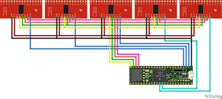

So I got the crazy idea to create a MIDI DJ Controller using a Teensy 3.6. I'll do a nice write up when I'm finished.
I am comfortable doing some MIDI stuff, writing C code, some soldering and like to tinker. I do not have much microcontroller experience though. I already have the Teensy 3.6, and I have ordered some hardware. I also have written some software and made a little design. Can you guys please check whether I am missing some big things?
For now, this is my design. The three multiplexers on the left will be connected to simple button switches. The two on the right will get all the middle pins from many rotary and slider 10k Ohm potentiometers.
Things I am unsure of:
  • Do I need to connect some/all unused pins to GND?
  • Should I use external power for potentiometers and the Teensy? If so, can I combine that with the usb-power safely?
  • Can I use multiplexers to power LEDs?
  • Am I using correct wire colors?
  • Will multiplexing analog and digital signals like this work?
  • Are there any best practises for MIDI signals/channels/messages?

Wow.... so that's how to initialize bounce and RAR arrays.
Still studying but looks good from what I can see. Did you seriously write this without the hardware already in place?
Just make sure you are not reading any floating pins. Pullups are on the digital lines but you might need to source or sink any unused pins on the analog mux... especially if they are polled in the code. And they need to be stable voltages during testing if you don't have all your pots set up.
https://www.pjrc.com/teensy/external_power.html ...there is no short answer to power supply.
yes...although the "like this" part remains to be seen.

  • As far as on the Teensy you don’t have to connect the unused pins to ground, for the multiplexers I can’t say otherwise.
  • I don’t believe you should need external power for potentiometers and should be able to power it over usb.
  • You can you use multiplexers to power leds, but you have to make sure your code runs fast enough to have no delays for the leds to look like they are all lit. The leds may also be dim because of how fast they have to switch on and off so you may have to play with resistor/voltage of the leds to get it to look how you want.
  • Wire colors are totally up to you, if you understand it that’s all that really matters.
  • You can mix digital and analog signal as long as you can filter out any interference in code, ResponsiveAnalogRead does a good job of this though.
  • I try to stick to control change messages that are undefined in the midi standard and you’ve already done this. I also don’t use note messages for buttons as most DAWs won’t be able to assign that to a parameter and I wouldn’t recommend to use the internal pull-up resistors in the long run, resistors are cheap and it’s easy enough to put one for each button.

Almost! In fact I was very much able to use and extrapolate this code for my project
This section is almost right:
void setupDigital() {
  for (int i = 0; i < DN; i++) {
    for (int j = 0; j < DIGITAL_MUX_PINS[i]; j++) {
      digital[i][j] = new Bounce(DIGITAL_PINS[i], true); // initialize
    pinMode(DIGITAL_PINS[i], INPUT_PULLUP); // internal pullup resistors for digital section
Should be:
      digital[i][j] = new Bounce(DIGITAL_PINS[i], BOUNCE_TIME); // initialize
Thanks!!
I ended up using shift registers to control my LEDs: 74hc595 as they hold the last state you put them in.
