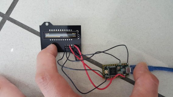

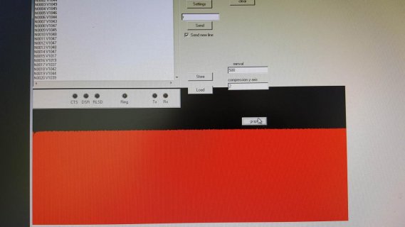

    thanks for your reply. I used the "2nd SMD-version" of the PCB from https://hackaday.io/project/9829-linear-ccd-module, it has an HC04 as inverter; the only difference is that I used a 2N5401 as transistor.
    I wrote a small windows program that show a graph of the values printed on the serial.
    I tested both 3v and the usb 5v as +V on the circuit. No differences.
    For pin connections I used:
    int fMPin = 3; // Mclk out 3 FTM1
    int SHPin = 14; //
    int ADCtrc = 6; // ADCtriggerClock out 6 FTM0, only internal use
    int ICGPin = 15; //
    int analogPin = A3; // Pin 17
    Must I connect something to pin 6 ?
    Now I read more or less 1040 on all the pixels, no matter if there is light/dark/ a black strip in the middle. What am I missing?
    Thank you very much!!

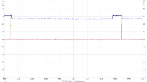

    The transistors emitter should be connected to 3,3V (with 2,2k) not 5V, because the ADC can only work upto 3,3V.
    Your connections are correct. Pin 6 must not be connected.
    I've added to diagrams from an oscilloscope, the blue line is pin 17 the analog pin, red line ICG.
    1. with much light on all pixels:Click image for larger version.
    2. with low light:Click image for larger version.
    As you can see in the second picture there are some pixels at the beginning and at theend of the ICG frame, which are at 3,3 V, that are the dummy pixels 0..31 and 32..45 at the end.
    In the first picture there is so much light on the CCD, that also those pixels are at the low voltage - too much light. All pixels read about 1400.
    I hope it can help, feel free to ask again, if not.
    Reiner

    It now works! Even if some things make me think: The TCD is REALLY sensible to he ambient light. I wanted to check the precision of detection cut-out slits in black cardboard. But at int_t integration time of 20000 the sensor was probably saturated, all pixels around 1700. I put the cut-out slits over the TCD, put 2 couples of (polarizer film sheet + another polarizer film at 90 blocking all the light), and a white paper sheet to diffuse the ambient light, and it works (see pictures) if the room is quite dark. Instead of the slits, each cut-out is a "round" valley, if I increment int_t time to 50000 it is better, a little bit. Is this normal? My goal would be to detect the position of a red laser (about 3mw) pointed at the TCD. I was able to measure its position, but ambient light sensisitvity is scaring me a little, if the sensor will operate in a dark room ok, but what if there is some more light? or it is operated outdoor? Is up to some degree solvable via firmware or electronically?
    Thanks!

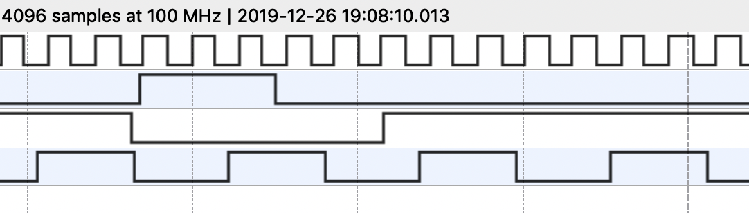

    Clock Signals (fM,SH,ICG) Click image for larger version.
Name:	Bildschirmfoto 2019-12-26 um 19.08.20.png
    Output (SH,OS) Click image for larger version.
Name:	Bildschirmfoto 2019-12-26 um 17.13.52.jpg
    Any Idea why i cannot read any values?

    You are showing four signals, but the CCD takes only three.
    I'm looking at the 3rd figure in your post, and assuming your four signals are (from the top)
    MCLK (looks ok, I can't read the frequency)
    SH (polarity is reversed and the delay from the falling edge of ICG is not long enough)
    ICG (looks ok)
    4th unknown, not sent to the CCD
    Also I cannot see the frequency (or period) of ICG vs SH. The periods must obey this relation ICGperiod = nSHperiod, and ICGperiod > 7,4 ms (assuming MCLK = 2,0 MHz) and SH > 10 s
    As reim suggest, try with very low values for the SHperiod. The chip is quite sensitive. In a normally lit room I see saturation with an SHperiod of app. 100-200 s

    hi all,
    i have been working on a TCD1304 project with some artistic inclinations, using a teensy 4.0
    i have had some success in reading out the signal and live streaming the output over ethernet (using a wiz850io board) to a raspberry pi for further processing (i was able to achieve a 4Mhz clock rate, which equates to about 270 frames-- i.e. lines of pixels-- per second). i have also implemented the electronic shutter function
    i realized that the waveform (SH, ICG, MCLK) generation code required to do the above was lacking-- too many interrupts and i was using delayMicros() to achieve waveform timing, which seemed like bad form. this manifested as timing slip between adc sampling and tcd1304 output
    i have just finished rewriting the waveform generation to occur in hardware with the flexpwm modules available on the teensy 4. the adc sampling can now be driven by associated interrupts, which means that i have precise timing control over everything! this required some deep dives through these forums, the teensy core libraries, and the IMXRT1060 reference manual. I have not coupled this portion with the fast adc readout and realtime stream yet, but i anticipate this working well as the two halves of the code are pretty modular. i have checked the TCD1304 output with a scope and it looks good!
    the next step, after getting the stream working with the updated waveform generation code, might be to use DMA to store the adc samples. right now, i am using pedvide's fast ADC library and it seems i can sample really fast (I tried to measure adc read speed at 12bits with no averaging and it seemed to be around 500ns; I have also verified this adc sampling speed by sampling known sine waves and looking at the output)
    here is where all this code lives: https://github.com/ntyrell/TCD1304
    here is just the pwm waveform generation code since i think it is the most interesting and widely useful part
    #define PIXELS 3648
    #define MCLK 4 // target TCD1304 clock rate in MHz; we will get as close as possible
    // calculate counter values such that an integer number of both 128x divided fbus cycles and MCLK cycles happen during each frame
    int CLKPMCLK = ceil((float)F_BUS_ACTUAL/(MCLK*1000000)); // f bus clock cycles per ccd clock cycles
    int MCLKPF = ceil((float)(32+PIXELS+14)*4/128); // number of ccd clock cycles per frame
    int CNTPF = MCLKPF * CLKPMCLK; // number of pwm counts per frame
    int CLKPF = 128 * CNTPF; // bus clock ticks per frame
    int USPF = CLKPF / (F_BUS_ACTUAL / 1000000); // microseconds per frame
    // make sure that 6 + 1 + 0.5 > 128*116 - (32+PIXELS+14)*4 i.e. there's enough extra time between pixels to set ICG low then high
    int CNT_ICG = (6.0 * (F_BUS_ACTUAL / 1000000))/128;
    int ES = 128; // how many times to divide framerate for electronic shutter [1 2 4 8 16 32 64 128]
    int CNT_SH = (1.0 * (F_BUS_ACTUAL / 1000000))/ (128 / ES); // divide by whatever prescaler to set shorter integration time
    int off = (0.5 * (F_BUS_ACTUAL / 1000000))/(128 / ES); // delay time between ICG low and SH high
    int adc_off = (0.0 * (F_BUS_ACTUAL / 1000000)); // delay time between ICG high and ADC sample start
    // for now the MCLK starts totally synchronized with ICG high edge but we could add a delay there too (datasheet says 0 delay is ok). I am not sure if I should change the polarity of the clock (do we want a rising or falling edge first?)
