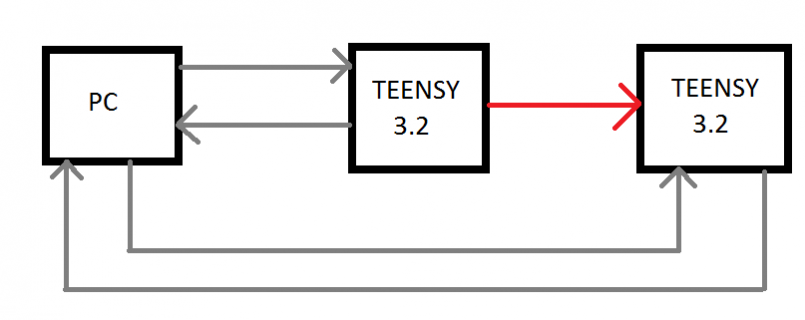

I am looking for the best ways to create a dependable network between two Teensy 3.2's, both using WIZ820io's, and a PC. I have to connect both Teensy's to the PC, one is close to the PC and one is a long distance away. I've been able to do this without many problems, but I am looking to expand on the current setup.
I would like the Teensy's to have their own connection, this can be a one way connection, or bi-directional. I am also interested in Auto-assigning IP addresses, a world I haven't entered but would like to understand more of.
The program written is a stripped down example of my network settings, this includes a counter and a triangle wave generator that are sent over a string once ever ~100 microseconds.

Perhaps a simple router with 5 port switch would do? Your PC, and two Teensy will be just as happy as they could be with a router. The router would also allow you to use DHCP just in case you want each teensy to get its own address. In a network and MCU controller environment its correct to have a switch/router as the center of your connections especially when your involving multiple MCU controlled network devices.
