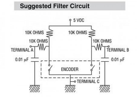

Starting with the Basic encoder example, I want to take an encoder value and map that to a 0-127 MIDI controller value.
Ideally - when I get to 127 it should continue to give me 127 and at zero continue to give me 0.
I've got some code which gives me that, however I get alternating values (+/- 1) for almost every turn of the encoder. Most obvious at the zero end where if I keep turning the encoder I get alternating 0 and 1's
Is there something I can do to avoid this jitter?

I don’t know what your circuit looks like but you may need to filter the outputs of your encoders, this seems to be a good example of a filter circuit for encoders.
However, since the jitter seems to be only one value off you could instead map the encoder as 0-255 and then bit shift it to the right before writing your new position variable. This of course makes you have to turn the encoder twice as far for the same value, so there is that. Is the jitter constant where if you don’t touch it it still jitters oris it only while moving the encoder?
