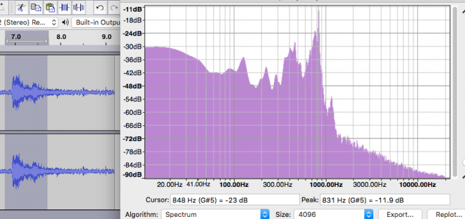

FWIW, i have simple sketch using AudioAnalyzeToneDetect with submarine sonar test at
https://www.youtube.com/watch?v=lj6h9acBTbI
// sub sonar https://www.youtube.com/watch?v=lj6h9acBTbI
// if audioout USB set USB to Audio in IDE
#define MIC_GAIN  3  // multiplier for the specific mic
AudioInputI2S            audioin;           //xy=145,151
AudioOutputI2S           audioout;           //xy=337,201
//AudioOutputUSB           audioout;
AudioAnalyzeToneDetect      tone1;      //xy=341,256
AudioConnection          patchCord1(audioin, 0, audioout, 0);
AudioConnection          patchCord2(audioin, 0, audioout, 1);
AudioConnection          patchCord3(audioin, 0, tone1, 0);
AudioControlSGTL5000     sgtl5000_1;     //xy=413,385
  AudioMemory(12);
  sgtl5000_1.enable();
  sgtl5000_1.volume(0.5);
  sgtl5000_1.micGain(46);
  tone1.frequency(830);
  //tone1.threshold(0.1);  // can test if (tone1)
  Serial.println("starting");
  if (tone1.available()) {
    float v = tone1.read();
    if (v > 0.1) Serial.printf("%d ms %f\n", millis(), v);
if i use tone1.threshold(0.1) and if (tone1) ..., i get a lot of same values from read()
i used FFT to identify the frequency bin. 500 ms ping event every 5 seconds ish.

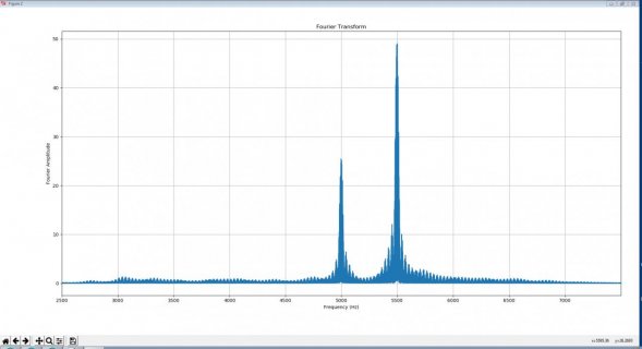

The ping.wav file contains a sequence of nine synchronized 5kHz and 5.5kHz ping-pairs, one second apart. The ping.png (unfortunate use of file extension) file is an image of the FFT.
Looking at the FFT again, I'm not sure why there is such an amplitude difference between the two frequencies--probably my speaker/mic setup.

I ran the code from msg #5 while playing the WAV file from msg #6.
I did need to increase the mic gain (my speakers weren't quite loud enough), and I set the tone detection frequency to 5000 Hz.
