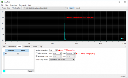

I have a project where I have to measure the frequencies of a mechanical device at low audio frequencies, mostly below 1KHz. The Audio Library's FFT1024 and 256 are set for a 22KHz frequency range with about 43Hz between each freq bin. For my project, I need a resolution down to about 5Hz or so...
With the help of a couple other posts from JBeale and Frank B. I was able to code a generic FFT with variable frequency range.
I am using the Teensy 3.2 @ 72MHz
Here is the code I am using:
In order to test the program, I am using the Teensy's onboard DAC set to a specific frequency, but can run at any test frequency by setting it in code.
Basically, the DAC output on the Teensy is connected to the A2 pin.
Since I am changing the frequency of the update rate on the DAC/ADC there has to be a multiplier for the DAC output frequency. See code comment.
This test program works with either the FFT1024 or FFT256.
Here is a screenshot of the FFT output (1024) in SerialPlot which works well with the Serial output of the Teensy.
SerialPlot can be downloaded here:
http://https://bitbucket.org/hyOzd/serialplot
I hope this help with other FFT projects...
