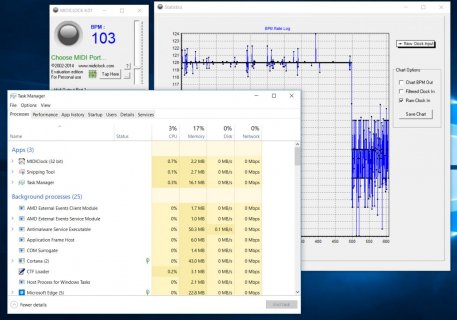

Issue: When connected to Win10 PC USB, sending MIDI clock (usbMIDI.sendRealTime) and MIDI notes, after about an hour the Teensy becomes very sluggish, eventually MIDI notes stop sending but clock still sends, though timing is erratic. This is fairly readily reproducible on our 3 Windows 10 PCs. This issue does NOT happen when connected to an iPad as USB host via camera connection kit.
After spending a few days trying to isolate the issue, we decided to just write some barebones code to do essentially what our own system is doing for clock and MIDI note output. So we whipped this up quick and dirty. The following will compile in Arduino with Teensyduino. There's a blink and some serial output just to see some activity, but you can use MIDI-OX or MIDIClock tool to monitor it. The MIDI sends section takes about 5uS.

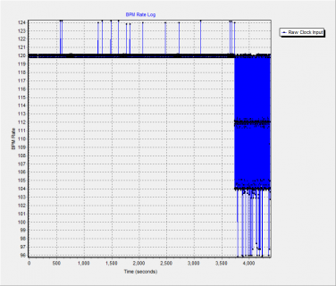

Images of clock timing when Teensy goes in the the bad condition, on two different PCs:

Test scenarios:
1) Send notes, but don’t send real time clock (by removing usbMIDI.sendRealTime calls) – fixes the issue
2) Send notes and clock to only one USB port – no change. That is, configured for only one virtual MIDI port rather than four.
3) On our system, we had an interrupt with a higher priority than USB. We changed the interrupt to a lower priority – fixes the issue, but its causing performance problems elsewhere. For instance, SPI display updates that cause a full screen redraw causes the MIDI clock to stutter badly. Hence the effort to fix this.
4) Once in the "condition" if we dynamically stop sending to USB MIDI the system returns to normal performance. We can use an encoder to change from USB to serial MIDI for instance, and performance returns. Then, clock out of HW serial is stable.
5)Doesn't happen with iPad as USB host even with our MIDI loop at a higher interrupt priority than USB.
6)Problem happens whether using a USB hub or directly connected to USB port on motherboard. USB 2 or USB 3 ports.
7)Doesn't seem to matter how fast or slow we are sending MIDI notes.
8)Doesn't seem to matter if software on Windows is consuming the notes or not. We've used MIDI-OX, DEXED and Arturia virtual instruments as MIDI receivers.
9)We recently added "usbMIDI.send_now();" as an experiment but it had no effect.
We could use some recommendations on how to further isolate the issue. It feels like a buffer problem or memory leak, but not sure how to measure it. Maybe some problem with interaction between Win10 USB or MIDI handler and Teensy USB MIDI?

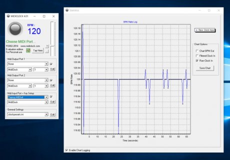

What software are you running to get those BPM graphs?
Please keep in mind I'm not a musician, I don't actually use MIDI software, and my primary desktop Linux, not Windows. But I do have a Windows 10 test machine here, and I have a USB protocol analyzer to really look at what's happening with the USB communication... if I can figure out how to set up this test. Any help and specific instructions on what to do with the Windows software setup would really help!
Thanks Paul! The two tools we use most are MIDI-OX (http://www.midiox.com/zip/midioxse.exe) for Windows and MIDIClock (http://midiclock.com/wp-content/uploads/2014/04/midiclock4.01.zip) for Windows.
It would be interesting to see if this happens on Linux. Maybe someone can recommend a MIDI tool? I'll take a look too. I tried to test it on an iConnectivity MIDI interface with USB host, but Teensy isn't recognized, it doesn't negotiate for some reason. We'll work on that with iConnectivity later :D
Launch MIDIClock.exe
Set the MIDI Input Port to "Teensy MIDIx4"
You can now monitor BPM. To see a graph (Statistics window) over time, click on the little graph icon next to the "Tap Here" button"
Uncheck "Chart BPM Out" and check "Raw Clock In", then at the bottom of the window check "Enable Chart Logging" to start logging.
I should add, that running the above sample code, just plug Teensy into USB on Windows and start the monitoring program. It immediately starts sending clock and notes. Also, I'm going to try this now, but you shouldn't have to use any program to monitor clock if you load a soft-synth and listen to the notes play. They will stop playing eventually.

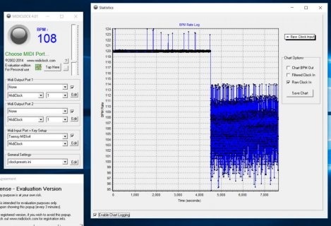

A new and interesting observation
Paul, maybe this will help with diagnosis...
After Teensy goes into the "condition", I opened a serial terminal and Teensy recovered! It started playing notes and the clock stabilized. It ran this way for a while then went back into the condition, at which point the serial monitor could not open the serial port. The content of the serial data had some old values (from when the Teensy was started) then jumped to current values. Like so:

Here's 2 strange things. First, I rebooted (actually several reboots due to a big Windows Update) but left the Teensy running. When I ran the program again, solid 120 bpm.
Then it started doing the problem after only ~8 minutes. I could heat the laptop's fan start to spin up. But Task Manager doesn't show anything else using much CPU. Very mysterious....

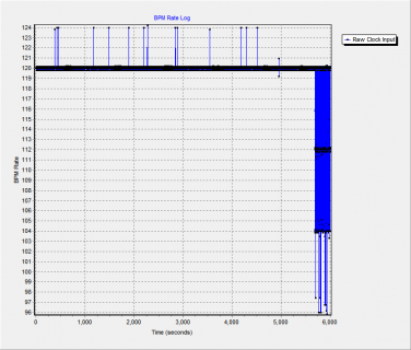

I was able to reproduce the problem here. Takes much longer on my machine, about 75 minutes.
Something that might help, is once it gets into that condition, if you open a serial terminal it will typically recover for a short time (10 minutes maybe?). it might give you a chance to see it fail again without the long wait.
