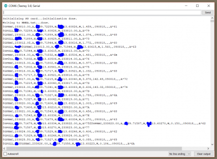

Hello all,
I'm working on a portable GPS logger based on the T3.6, but I've been stuck on a weird issue I've been having regarding missing characters.
My code reads raw NMEA data from the GPS, stores and stores it in a 256-byte buffer. When the buffer is full, it dumps the contents into a .txt file an SD card. The problem is, it will randomly skip characters, sometimes only 2-3, other times whole sentences. What makes this more interesting is that if I comment out all of the data-logging code, I no longer have this issue.
My initial reaction was to add a 4700uF capacitor to the VDD line (overkill, I know :D) in case current spikes during the SD write-cycle somehow caused the GPS to glitch out, but that didn't seem to fix the problem. For what it's worth, I'm using a PNY High Performance 32GB card in the T3.6's builtin slot. Although this could very well be the problem, my gut tells me it isn't the case.
Now I'm wondering if the SD write routine has a higher interrupt priority than the Serial read buffer, which would cause it to completely miss chunks of data.
I have a few theories as to what it could be, but I would like a fresh set of eyes to check my code and make sure there isn't something I missed.
Here's my code.

And here's an example of the data I'm getting.
You probably want to use Serial1 or Serial2 as these have 8 byte hardware fifos.
From: https://www.pjrc.com/teensy/td_uart.html:
On Teensy 3.2, 3.5, 3.6, Serial1 and Serial2 have 8 byte transmit and receive FIFOs, which allow for higher speed baud rates, even when other libraries create interrupt latency.
All serial ports on all Teensy boards use interrupt-based transmit and receive buffering, to allow your program to avoid waiting when writing short messages, and to allow data to be reliably received even if your program must spend time performing other tasks.
On Teensy 3.6 when running faster than 120 MHz, writing to EEPROM may momentarily interfere with Serial1 and Serial2 baud rates. Reading EEPROM does not interfere. Serial3 to Serial6 are not affected.
If your GPS supports hardware flow control, you may want to enable it as well. See the link above for more details.

IIRC doing block writes of 512 bytes is more efficient - it will fill a block in one write without the need to have the card manage half write/read/rewrite.
That might speed the logging.
Moving to Serial 1 or 2 would be best to maximize hardware and minimize needed interrupts.
And possibly attempts could be made to read data from serial buffer between steps in the log process to make sure the Rcv buffer doesn't overflow when a long pause for SD write happens.
Data rate at 115200 is slow enough - last I used was 460800 with no loss on Serial2, with attention to detail - though did extend the hardware serial buffer to 128 Bytes IIRC because the system would hang long enough to cause loss doing calcs at the wrong time with a 100+ byte message. Not sure what string length of the messages here is - or the repeat rate 1, 5 or 10 Hz?
Suggest perhaps using charbuf to full twice then transferring to logbuf[512] - then complete buffer empty Serial read to charbuff before starting the logbuf[512] write. Or just make two [512] buffers and toggle between read and log with them.
If charbuf was all but full when a new message arrived - remainder would be partially read and waiting during the log process - this is probably the case now.
Also with the above double buffering - if there was interrupt and loss/contention during logging - you could time from the end of the last received message and know how long before the next would start 100 or 200 ms. Then do the logging then to avoid data loss. I wrote a serial start bit detection _isr() and some long stuff would be delayed as the transfer was about 5 ms and the calcs were about 750ms or longer on a T_3.5.

serious data logging should always be done with double/multiple buffering.
Rule #1: never ever allow data acquisition to be influenced by down-stream activity.
Rule #2: think about and always handle situations, where data processing (here logging) does not keep up with acquisition
IMO, defragster is right, that logging latencies (up to over 100 ms) interfered in your example with the capability of the serial port.

It works! I changed it so that it only logs to the SD card after 50 ms of no serial activity.

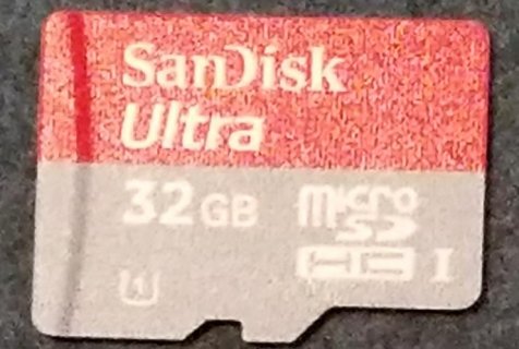

The SD started with a clean SDFORMATTER setup, it is a 32MB SanDisk Ultra, of course by now it has been hit by some many dozens of rude restarts. Last time I had it out I deleted the file and did a chkdsk and it was clean. To allow a clean shutdown just added:
if (Serial.available()) while (1); // pause before any restart by sending anything out USB
Pulled the card and no data errors, and 50K of well formatted data! Doing an 'Overwriteformat' to be sure it can be good for writing after so many delete/create/abort hits on the same file to see if the 422 ms goes away, first MAX values I saw were 20 to 50 ms. Will start overnight when format finishes.

Full Format completed - within 360 block writes I see 41 ms :: 360 << # writes 415052 << MAX write time
Then getting here I look over and see this 419.8 ms >> 380 << # writes 419858 << MAX write time
No lost strings with the larger buffer. I meant to pull full details of the card as I can only see 'san' 'ult '32' with it plugged in.
The next 123 writes passed under 50 ms . Avg write is 3.5 to 4ms. Another 220 just passed under at 4.15 ms or under before hitting an 85 and 53 ms on the next 2 writes.
This is a bare T_3.6 with female headers - no GPS - and just GND and Rx to the T_3.1 on separate port - w/T-3.6 powered by PC Front USB3 port so it should not be lack of power - just the card. I'll restart with slower baud to spread the Rx interrupts ...
This isn't conclusive - but suggestive - at 115200 the MAX wait only cross 100 ms twice with more writes than prior test:: 1580 << # writes 118060 << MAX write time
Recompiled at '921600' baud to compare - no horrid hits like before >> 700 << # writes 139924 << MAX write time
Took the message size to 200 on so Rx xfer lasts the same time as before to interfere with SD writes if it wants too - also twice as much written to SD so more chances to conflict?
Early results are no worse? Maybe moved to a fresh SD block?
Except one error message w/ length 304. This is better than was seen at half the baudrate and data volume :: 3600 << # writes 139972 << MAX write time

BTW: This was bought as a retail packed SanDisk card?
<edit> Found a fresh Adata 16GB card - been running some time:
14591 << avg us 49260 << # writes 577 << # >50ms 270901 << MAX write us
I don't suspect the SanDisk was used hard a lot - but the fresh Adata is not as extreme in slowness.
17071 << avg us 72020 << # writes 851 << # >50ms 270901 << MAX write us
