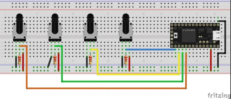

I'm trying to read four soft pots like this one (https://grobotronics.com/softpot-membrane-potentiometer-200mm.html) with a Teensy 3.6 but I can't get it to work properly.

Here's a Fritzing image of the circuit with normal pots instead of soft pots, cause my Fritzing installation doesn't have a soft pot part.
Any ideas why this works with Arduino but not with Teensy?

Is it possible there's some problem in the circuit that causes this issue with the Teensy? In the OP I have uploaded a .jpg with a Fritzing image of the circuit, replacing the ribbons with normal pots. The resistors are 10k, as well as the pots. The pull-down resistors are there so that I get a 0 when I don't press a ribbon. Again, this circuit and code works fine with an Arduino UNO.
