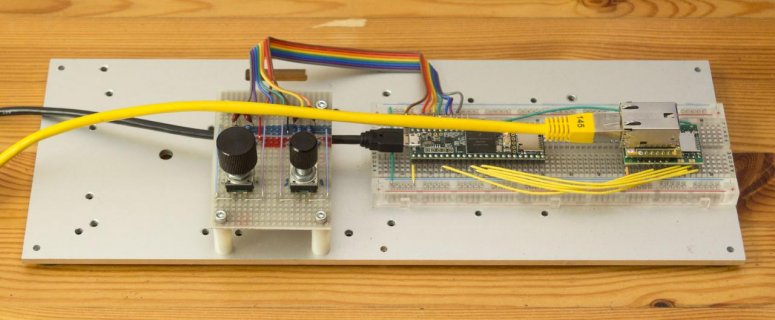

This is what my test setup looks like:
Two rotary encoders I had from a previous experiment, hardware debounced as suggested in the Bourns datasheet. The ethernet is handled by a wiz850io on the adapter board. On the hardware side everything is working perfectly. Now I have to figure out the software side of it.

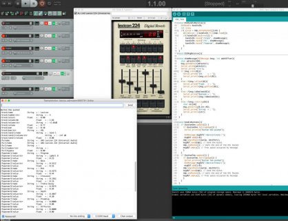

This screenshot gives an overview of how things fit together (OSC treated as bundle):
The serial monitor shows the Reaper response after the left encoder button has been pressed making track 5 the selected track. All track parameters are sent complete with readable insert names and all. Even the effect parameter names are complete and not some cryptic six character summary like with the Mackie MCU or HUI protocols. A nice benefit of using OSC communication in stead of MIDI is the fact that Reaper does not complain about missing midi devices when compiling and uploading the code to the Teensy but the most important part is the level of detail in the messages. What I've seen so far opens up a whole new range of possibilities.
