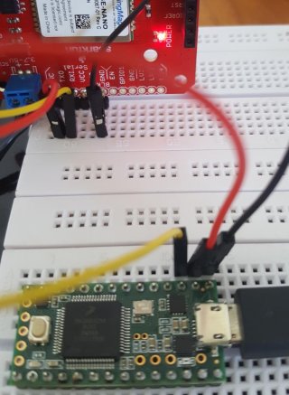

I'm using the SparkFun Simultaneous RFID Reader and would like to communicate over hardware serial with a Teensy 3.2. I successfully tested the reader as a shield with an UNO, using an example sketch that talks to the UNO over software serial. I've taken that example sketch and replaced usage of SoftwareSerial with Serial1 and wired things as shown in the photos.
Here is the sketch, where I've replaced SoftwareSerial with Serial1:

On line 22, the call to
setupNano(38400)
fails, returns false, and the sketch stops at the infinite loop placed in line 25, after printing "Module failed to respond. Please check wiring."
This is my first attempt at hardware serial, so I'm not confident in my code or wiring to be honest.

Maybe try swapping the yellow and red wires?
The printing on Sparfun's board seems confusing. It shows "TX" on pin 1 where the red wire is connected, and "RX" on pin 0 where the yellow wire is connected. But those probably are not how this shield actually works. Those are probably just a copy of the labels printed on Arduino Uno. Uno & Teensy transmit on pin 1. This shield almost certainly receives on pin 1, even though the printing says "TX". Likewise for pin 0, Uno & Teesny receive on pin 0, so this shield probably transmits on pin 0, even though the label says "RX".
If the printing on the shield accurately documented the way it really works, then the way you connected the wires would be correct. But the printing is (probably) wrong for this shield.
Connect pin 0 from the shield to pin 0 on Teensy, and pin 1 to pin 1.
I tried swapping the wires, to no avail.

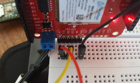

This is the response I got from SparkFun:
"The switch just selects which pair of shield pins the module is connected to. HW-UART connects the module to pins 0 and 1 while SW-UART connects the module to pins 2 and 3. You can also bypass the switch all together by using the RX/TX and GND pins that are on the ‘Serial’ header at the top of the board..."
So I tried using the pins at the top of the board, same issue. Photo attached. I tried with a Teensy LC in case the micro had been damaged, but no change there either.
That connection looks correct. The signal names line up properly with the FTDI serial cable I have here.
Why it's not working, I do not know.

When I try running the USBtoSerial example I get the single character 'C' in the Serial Monitor, when the reader is first powered on. I don't know if that is a proper interpretation of the firmware version, but it is something!

I inserted a statement to print the error condition out before it fails. The error code is '3', defined in the library as
ERROR_WRONG_OPCODE_RESPONSE
The library compares the opcode sent with the outgoing message to the opcode in the reply. If they are not identical it it results in this error. If I remove a wire, or reverse them, I get
ERROR_COMMAND_RESPONSE_TIMEOUT
So, it appears that there is data coming from the reader in the first case, it just isn't what is expected. Could this imply a baud-rate mismatch? I'm actually not totally clear on how this code properly negotiates the baud-rate if it isn't right to begin with.

Hi Guys, i got it woking.
Way overtime but could be of use to someone.
here is what you should do:
-connect via Serial pins TXD RXI,
-Vin of the sparkfun board at 3,7V
-Arduinocode: example hardware Serial. change every hardware serial5 to 1.
rocknroll.
i havent got it working at 5v. my lvl shifter isnt working.
