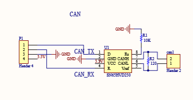

Just for the heck of it I put together a small breakout board designed around the T3.2 with a SN65HVD230 CAN transceiver. That part of the circuit is based on the Waveshare mini-breakout board:

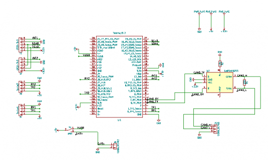

I already have 4 of them and they work well but wanted to incorporate one onto at the board level. The schematic for the board is:

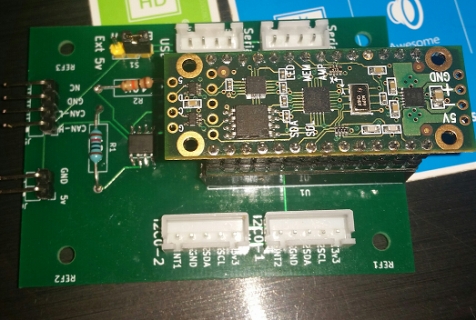

I had a few PCBs made and was just testing it but for some reason it is not reading packets coming to it. I checked the circuit with a multimeter to make sure connections were going where they were suppose to according the schematic. But no dice. Did check the voltage to make sure it was getting power to chip, and it was.
Below is a photo of the board:
If anyone has any ideas it would be appreciated. Because I can't see what I am missing.

I changed to the MCP2551 and circuit still didn't work. Something is wrong somewhere and just don't where
The MCP2551 is a 5V part. Did You Change the VDD-voltage ? Also I don't know if the Transceiver will recognize the correct Level when used with a 3,3V Output by the teensy.
On my PCB I plan to use a MCP 2562FD-E/SN. It has 5V power supply but on Pin5 You provide the reference I/O voltage to use with a 3,3V microcontroller.
Thanks AutoMike - yep I rewired the 3.3v to the 5v pin. Forgot to mention that but finally figured out my problem. For the MCP2551 I actually used a MCP2515 and was using the wrong chip in for the ti sn65. I had the parts in the wrong bags. I ordered some new ones from Digikey - won't have until next week though. So it should work.
Hi all. Now that I am using the correct transceiver, I tested it today and its working fine. Here is picture of what the board is suppose to look like when it is loaded. Right now it has the T3.2 with a propshield attached;
