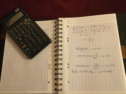

I’m actually thinking about the same question. In theory, I’d decompose F_PLL or F_BUS on the left side and the desired system clock (samplefreq x bits/frame x 2) on the right side into prime factors and eliminate as much as possible common factors on both, so that I’d get the smallest possible values on both sides which would then be the multiplicator right and the divider left.
An example...

Thank you both!
@WMXZ, your code returns wrong numbers for certain values. Some lead to slightly off frequencies.
@Theremingenieur, your idea works :) - I wrote some code for it:

@Theremingenieur: We have to take into account that MULT is 1..256 (-1) and DIV is 1..4096 (-1), and there may be no exact solution.
edit:
MCLK Fraction
Sets the MCLK divide ratio such that: MCLK output = MCLK input * ( (FRACT + 1) / (DIVIDE + 1) ).
FRACT must be set equal or less than the value in the DIVIDE field.
I did not explicitly mention the need to subtract 1 on both, multiplier and divider, because it seemed self-understanding to me. Using primes from 2 to 13 as you do, will only allow for perfect factorising 3 significants up to 169. 44117 has 5 significants, so you would have to check all primes up to sqrt(44117). But I see that 44117 is 157 x 281 and thus has no common factors with F_BUS or F_PLL, so no algorithm would be suitable to find integer multipliers and dividers.
But wasn’t your effort about eliminating that ugly non-standard sampling frequency???
