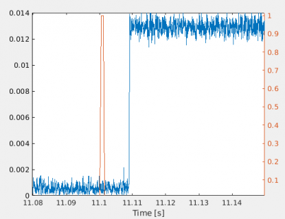

So I've changed my code to utilize a timer as you've suggested. However, I've noticed about a ~6-8 ms delay before I see an increase in the amplitude of a sine wave. I've attached the code, but basically, here is a plot of a digital pulse from a different pin and the amplitude envelope of the filtered sine wave, and my code as modified. Essentially, I use ellapsedMicros to initiate a change in the amplitude envelope, and I am measuring the change in voltage out of the audio pin on my Teensy 3.2. Does anyone know of a reason for the delay? I notice it's a little over 2 blocks long if each is approximately 2.9 ms.

And here is an image of tone latency (difference between the rising time of the blue line, which is the tone's amplitude envelope, and the orange line, which is the digital pulse):
